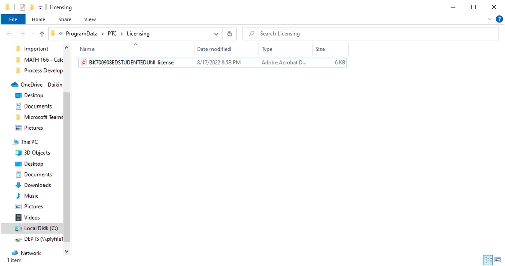

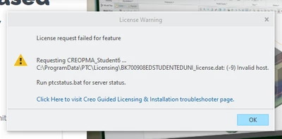

Good afternoon,
I am trying to get into Creo Parametric 7.0.8.0, but am getting the following errors - these three errors pop up and then the program automatically closes. Any thoughts on what needs to be done to fix this?
Thank you for the help!

Similar issue before - "Licence request failed for feature, error (-9) Invalid host": https://community.ptc.com/t5/PTC-Education-Forum/Licence-request-failed-for-feature-error-9-Invalid-host/td-p/782501
August 18, 2022
license file is generated for network card physical address which is not available.

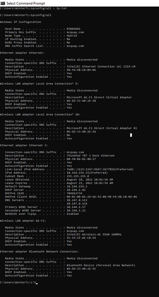

Please upload your license file and ip.txt file generated by command ipconfig /all > ip.txt in Command prompt window. I'll check these file and let you know.

in ipconfig /all output I found following physical addresses:
internal Ethernet ... 98-FA-9B-CB-09-06
Thinkpad TBT Ethernet 3 ... 00-50-B6-B1-B0-17
Wireless ... 5E-55-CE-AE-C8-59
One of these addresses must be present in license file.
I do not know what physical address is used in license file, because you did not upload this file. Please upload the file -OR- open it in Notepad and publish picture of file part which contains INCREMENT line.
NOTE: If you use docking station, try unplugging notebook from it.
