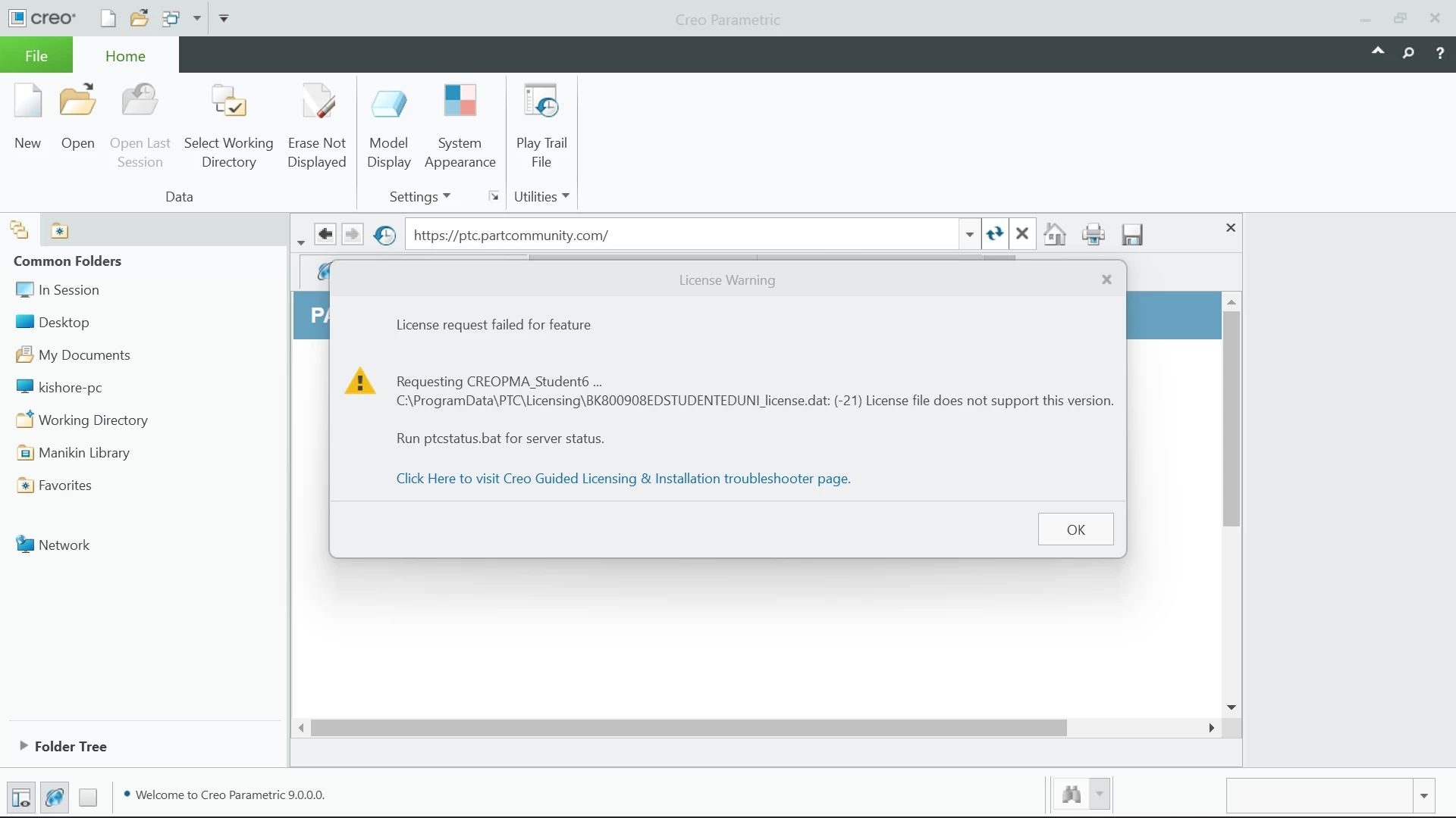

License request failed for feature Creo 9.0
  • July 18, 2022
  • 3831 views
I get this error when I open Creo Parametric 9.0.0.0 which says
Requesting CREOPMA_Student6 ...
C:\ProgramData\PTC\Licensing\BK800908EDSTUDENTEDUNI_license.dat:(-21) License file does not support this version.
Run prcstatus.bat for server status
Any help to solve this problem would be appreciated.
Best answer by MartinHanak
BK800908EDSTUDENTEDUNI code is related to Creo 8.0.
When installing Creo 9.0, you have to use BK900908EDSTUDENTEDUNI
