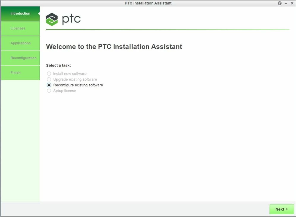

I have been running CREO 3.0 without any problems until my school decided to upgrade to CREO 4.0. Each time I do my work at school, I had a hard time trying to do the homework assignment on my own computer. So, I decided to install CREO 4.0 student version. I followed the instruction, but each time I attempt to run it the below warning message comes up. On C:\ProgramData\PTC\Licensing the BE41078EDSTUDENTEDK12_license.dat is in the folder but it still not allowed to start the program. Can anyone help??? Thank you.

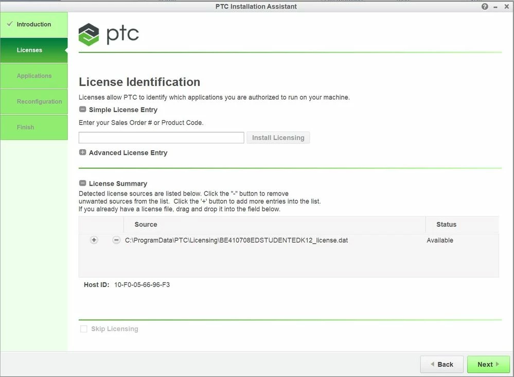

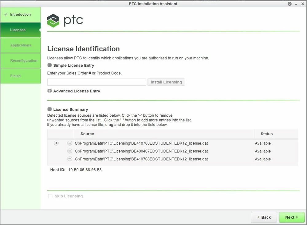

Ok, I got it. On your desktop: Program Files > PTC > Creo 4.0 > M030 > Parametric > bin
Then open the "reconfigure" shortcut. It'll take you to what looks like the install window. Hit next, deselect all licenses EXCEPT the BE410708EDSTUDENTEDK12 (if there are two like in my pic, you only need one). Then hit next again and it will reinstall creo parametric and fix the issue. step 1.JPGstep 2.JPGstep 3.JPG
