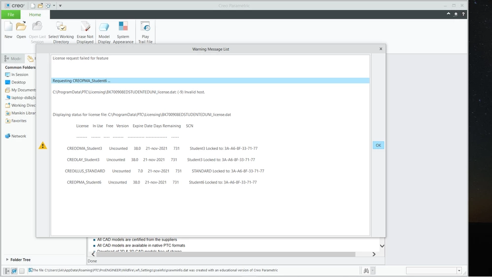

why no one is replying is to my problem I am facing with the software license request failed for feature
pls help me
November 24, 2020
license file mentioned on 1st picture contains license generated for network card with MAC address 3A-A6-8F-33-71-77.
Invalid host error message tells you that Creo did not found network card with MAC address 3A-A6-8F-33-71-77.
Suggestion:
  • open Command prompt window
  • run ipconfig /all > ip.txt command
  • upload ip.txt file
  • I will check contents of ip.txt file
November 24, 2020
i did attach the file
November 24, 2020
I can't find 3A-A6-8F-33-71-77 in ip.txt file. Therefore you cannot use your license file to launch Creo.
I am not sure whether PTC installer work well when your computer is connected to Internet via Remote NDIS based Internet Sharing Device (22-F6-4F-3C-12-86).
Suggestion: Connect to Internet via Realtek PCIe GBE Family Controller (8C-16-45-6B-B2-97) and disable all other network cards. Then uninstall Creo, clean C:\ProgramData\PTC\Licensing directory and install Creo.
