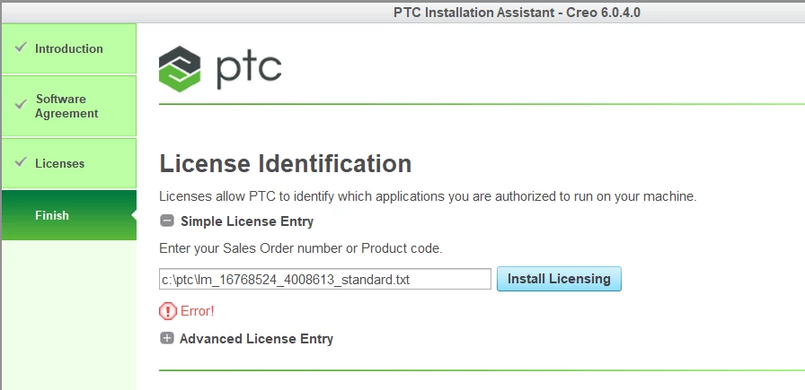

I'm trying to install the licensing for CREO.  I follow the steps they gave me at the university but when I execute the step for the licensing I get an error.  How can I solve this ?

you entered the path to the license file in the wrong field. Enter the path in the Source field in lower half of the window.
Important note: MAC address of network card included in license file must correspond with MAC address of network card available on your computer.

OK, that worked.   Thx for the support
