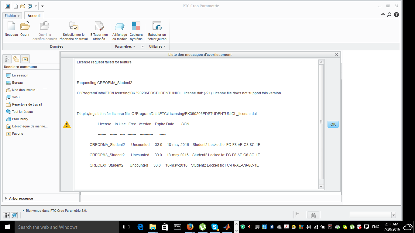

i have tried to launch creo parametric3.0 and i have the error message that appears below
    July 21, 2016
    your license (saved in C:\ProgramData\PTC\Licensing\BK390206EDSTUDENTUNICL_license.dat file) enables you to run versions up to Creo Parametric 2.0, only.
