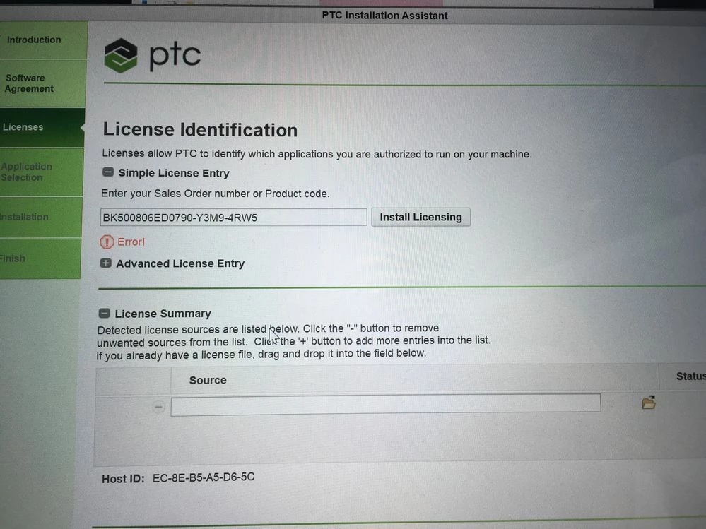

Hello all,
Yesterday I have downloaded Creo 5.0 student version and the installation worked fine.
But after opening the application it is showing that the license is not valid for this version. What should I do?
Best answer by MartinHanak
please read attached documents and check steps described in them. Next time please attach some picture reporting your problem.

So frustrated with install of Creo 5.0 on Windows 10....nothing but non-specific error! messages 😞IMG_7054.JPG
May 13, 2019
check your email box ... maybe PTC sent you license file via email.
In case that you received email:
  •  save license file to disc
  • launch installation
  • do not enter Product code
  • enter path to license file to Source field
Sometimes installer has problems with network cards. Please open Command Prompt window, enter ipconfig /all > ip.txt command and upload ip.txt file. I will check its contents.
