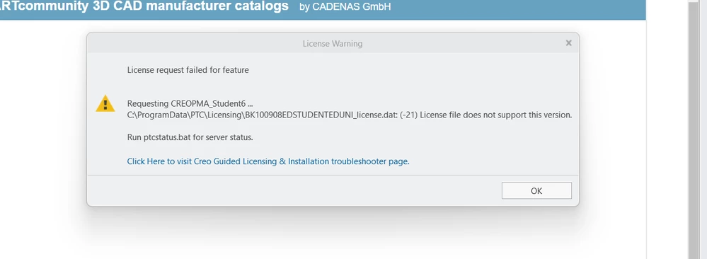

Hello!
I have just installed Creo 11, but when i open it, it shows this problem.
How can i resolve this problem?

license file mentioned in uploaded picture belongs to Creo 10.0. It does not work with Creo 11.0.
You can request Creo 11.0 license file via email. Please read https://community.ptc.com/t5/PTC-Education-Forum/Creo-Parametric-9-0-Student-Edition-Licence-error/m-p/897846 discussion.
