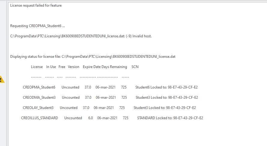

I am using Creo 6.0 with my laptop connected to a dockingstation and it´s working fine. Ethernet and wireless. Both is working. If I disconnet the laptop from the dockingstation i get the attached error when I start Creo.
regards,
Marc

maybe MAC address 98-E7-43-29-CF-E2 shown on the picture is related to docking station, only.

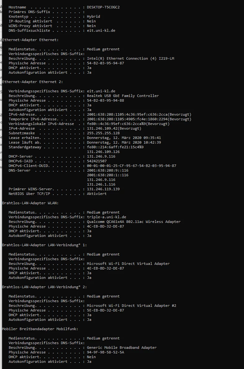

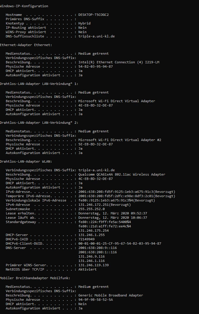

1.] put laptop into dockingstation and run ipconfig /all > ip1.txt from Command prompt window
2.] disconnect laptop from dockingstation and run ipconfig /all > ip2.txt from Command prompt window
3.] compare contents of these files (you can upload them and I will check them...)
  • look for MAC address 98-E7-43-29-CF-E2

I've attached both pictures. Funnily enough, I can't find the MAC address on either one

1.] please next time upload text files containing ipconfig output
I think you know that ipconfig /all > ip1.txt creates ip1.txt file in working directory.
2.] can you remember when and how you were connected to Internet ?
It is strange that MAC address 98-E7-43-29-CF-E2 was available during Creo installation and now it is not present. Did you disable some network card ?
