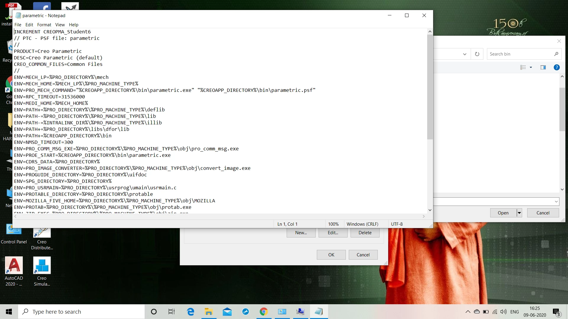

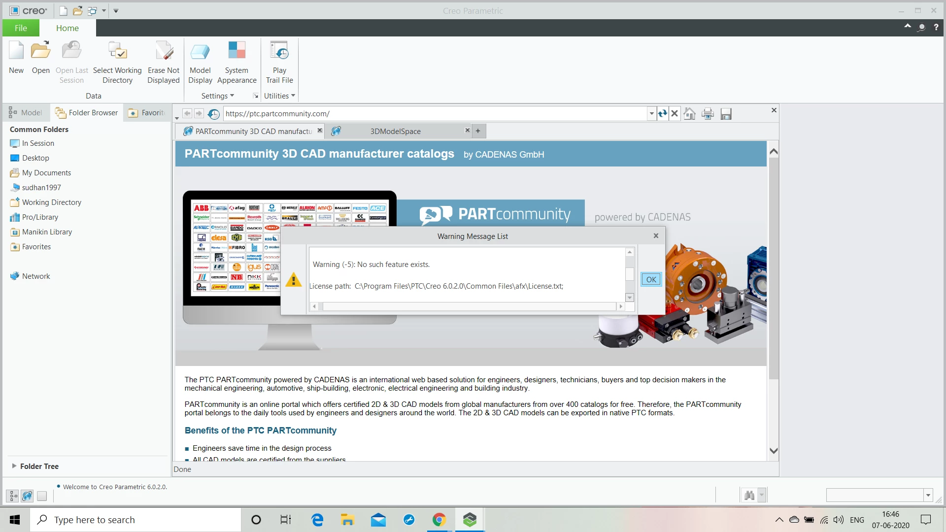

@mnhari97 wrote:
i have also same problem. any one can known clear this issue please tell.

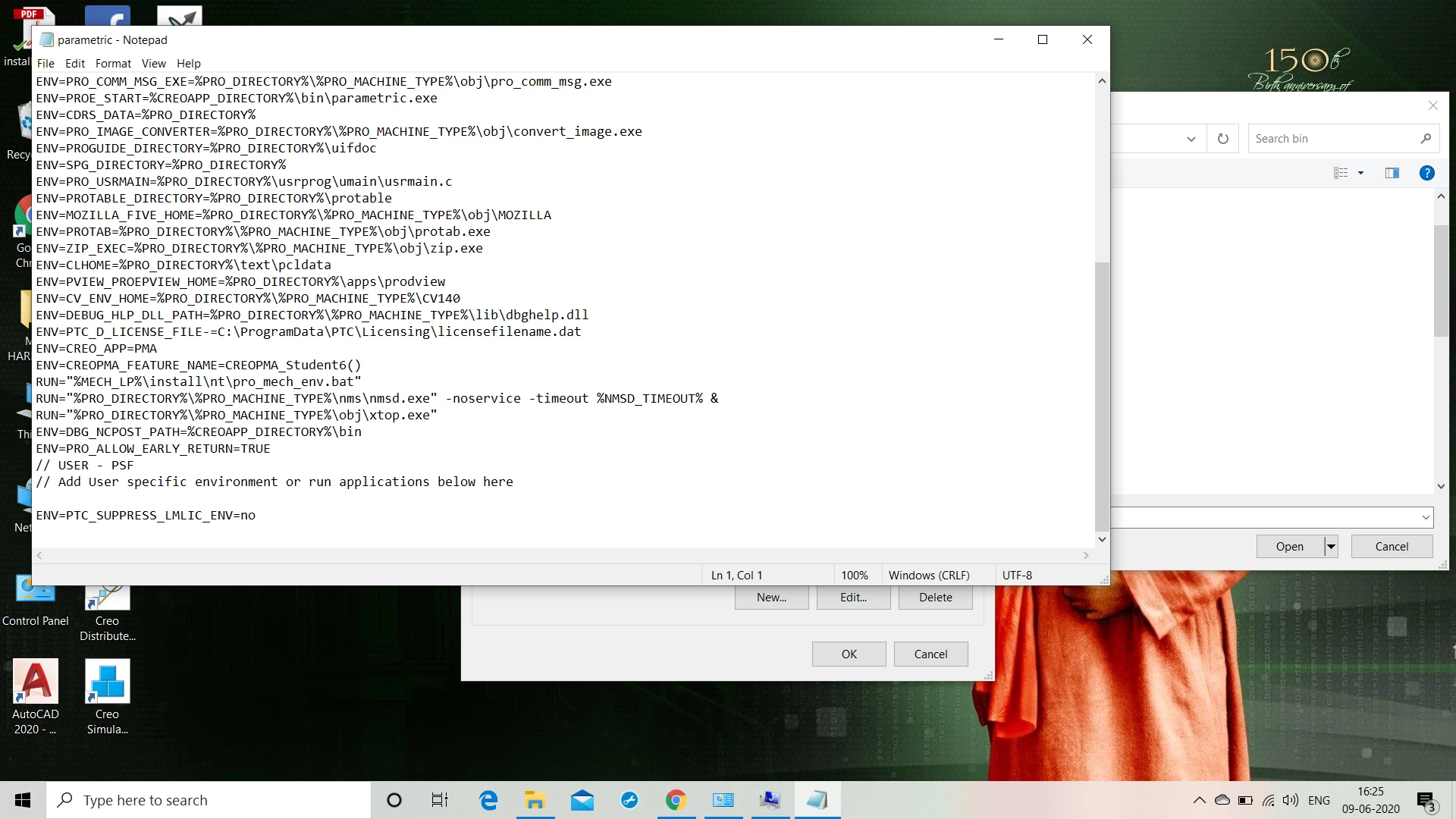

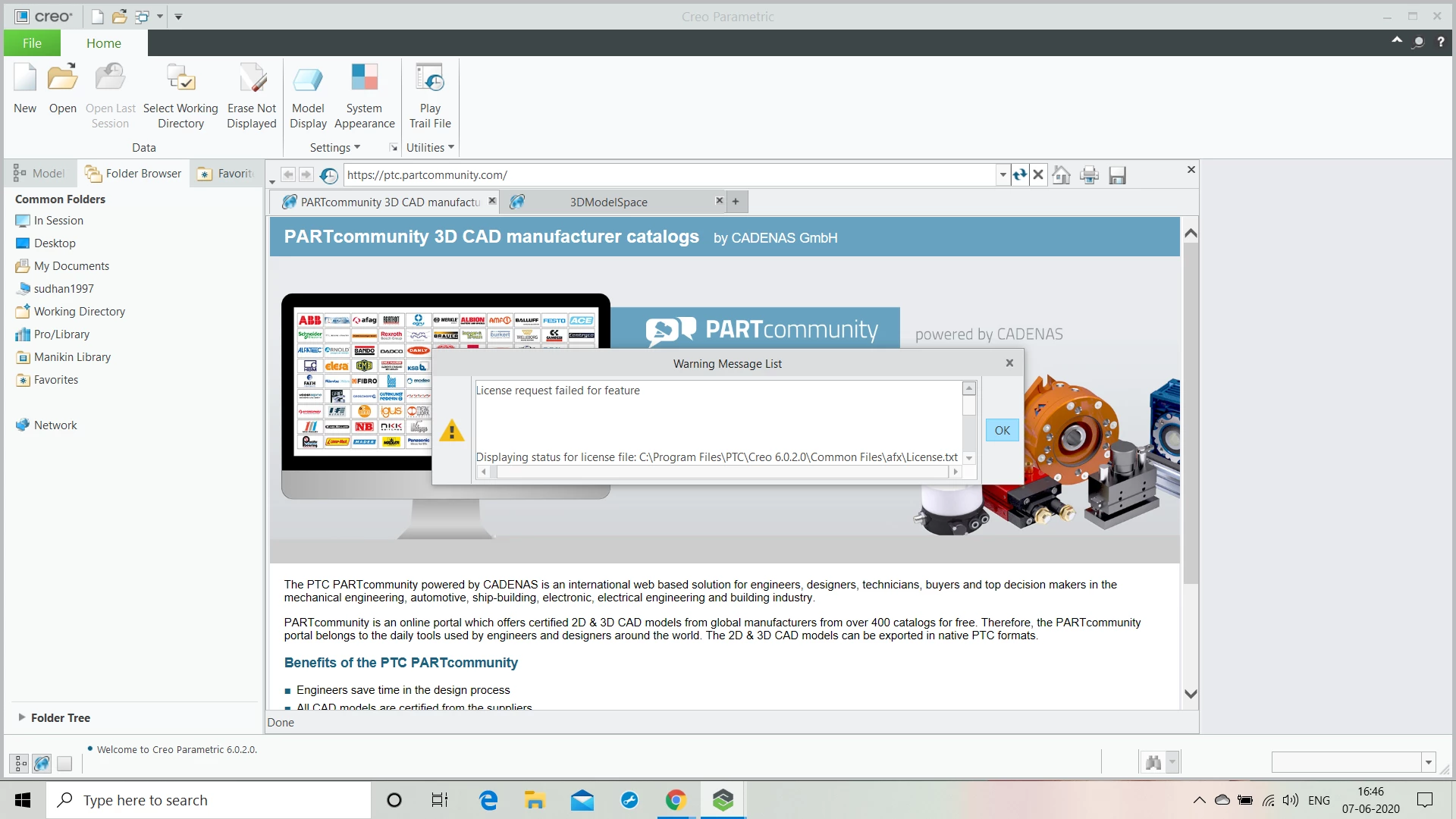

Creo 6.0.2.0 installer places license file into C:\ProgramData\PTC\Licensing directory.
On your pictures I can see C:\Program Files\PTC\Creo 6.0.2.0\Common Files\afx\License.txt. This file does not contain Creo license.
1.]

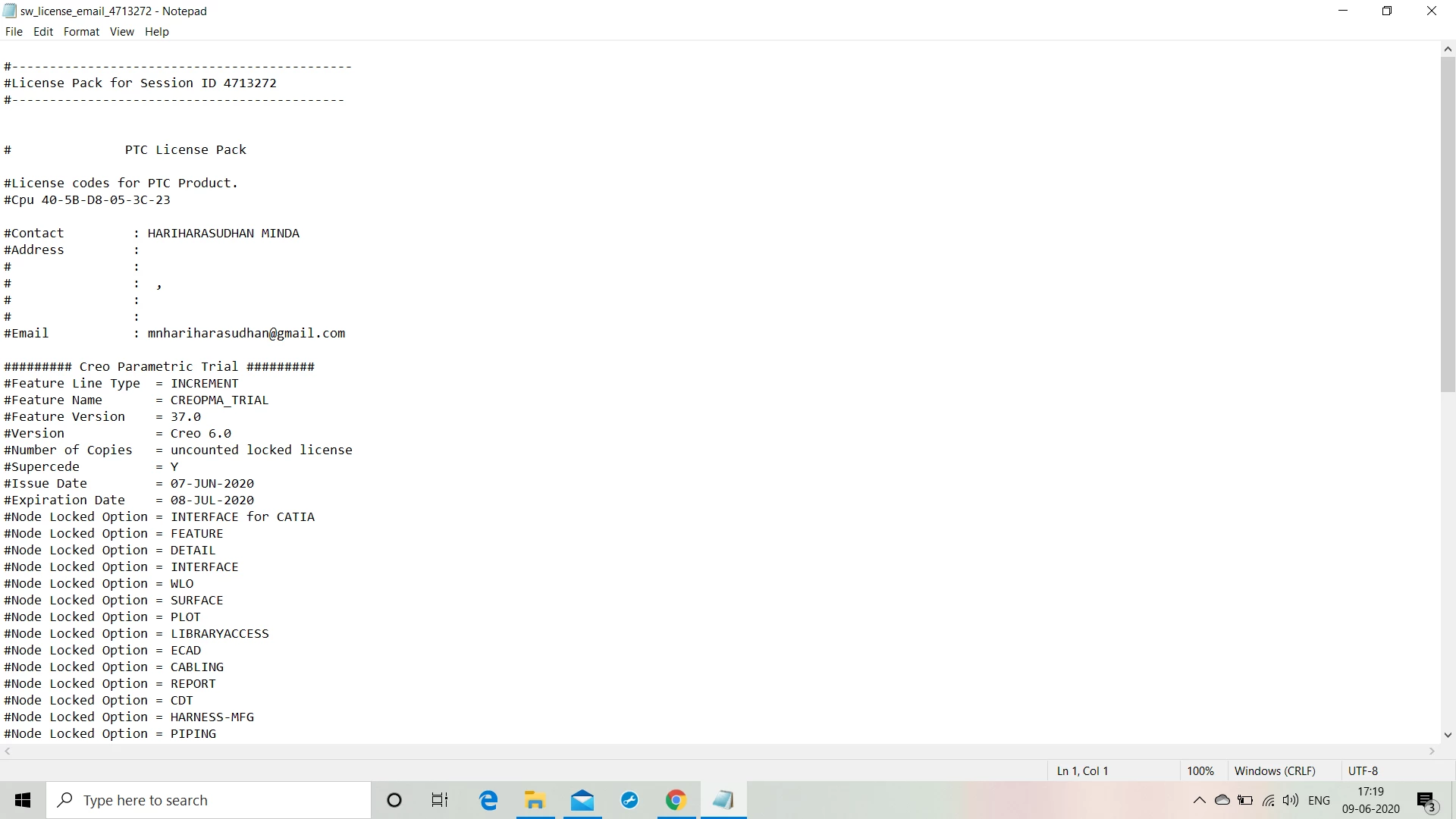

Look what's in C:\ProgramData\PTC\Licensing directory. If it contains valid license file (name of the file is something like BE600908EDSTUDENTEDK12_license.dat -OR- BK600908EDSTUDENTEDUNI_license.dat) then you can proceed with step 2.
2.]
Open C:\Program Files\PTC\Creo 6.0.2.0\Parametric\bin\parametric.psf file in Notepad.
Check&modify two following lines.

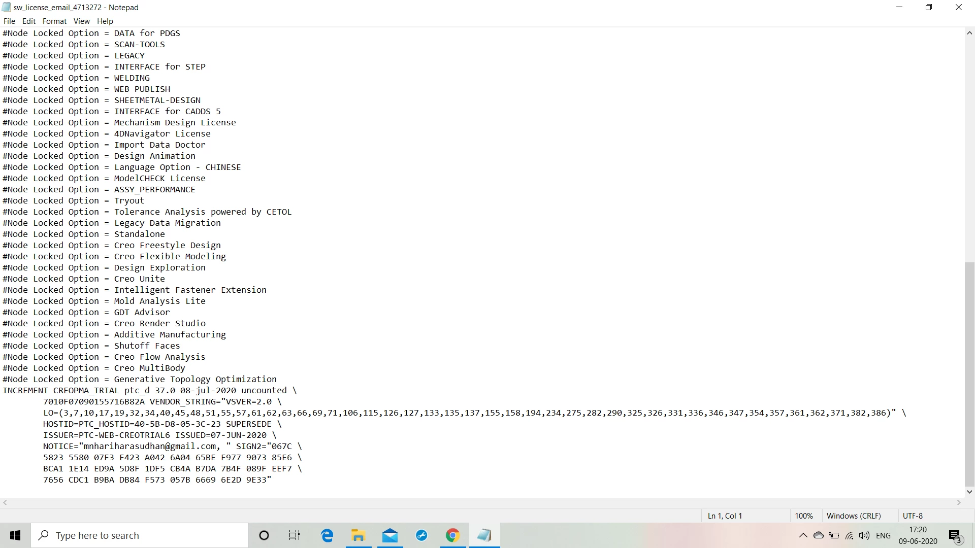

ENV=PTC_D_LICENSE_FILE-=C:\ProgramData\PTC\Licensing\licensefilename.dat
ENV=CREOPMA_FEATURE_NAME=CREOPMA_Student6 ()
Note: Your license file must contain line beginning with INCREMENT CREOPMA_Student6.

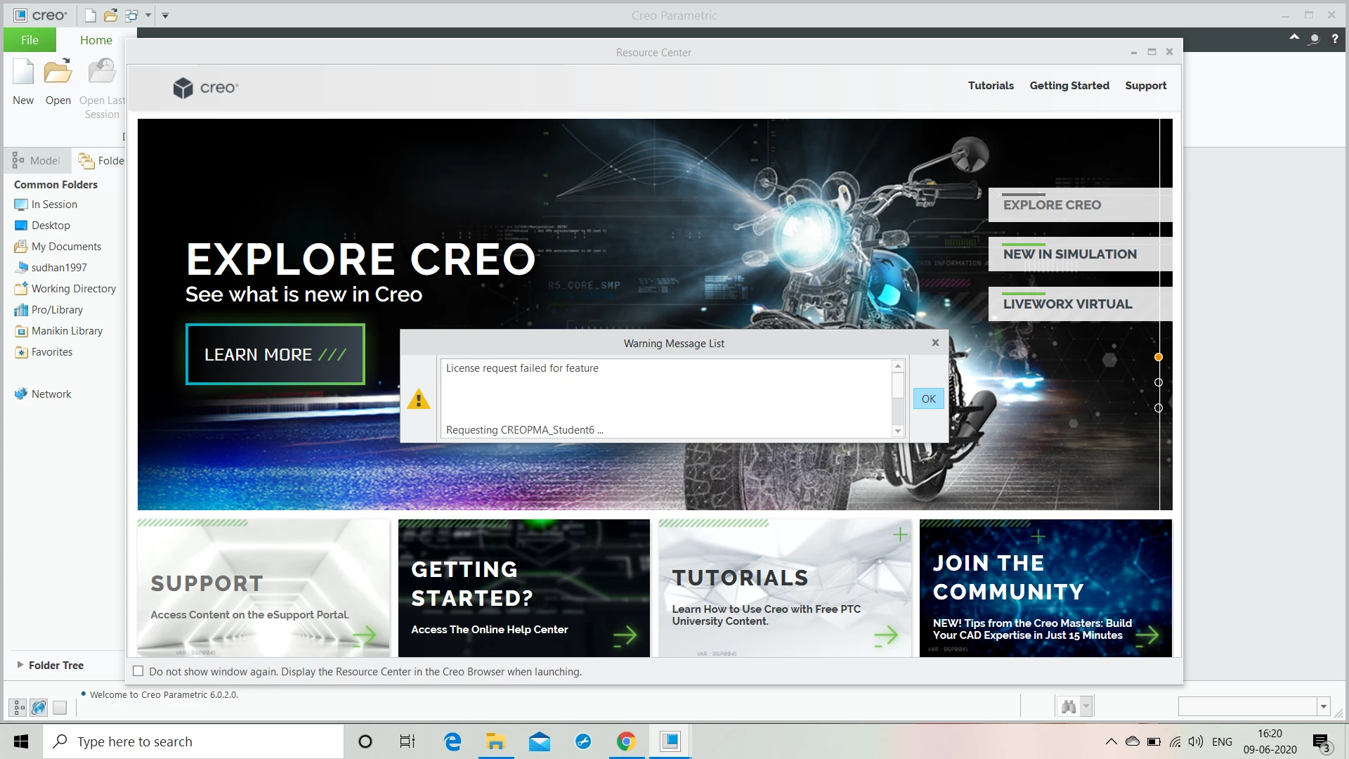

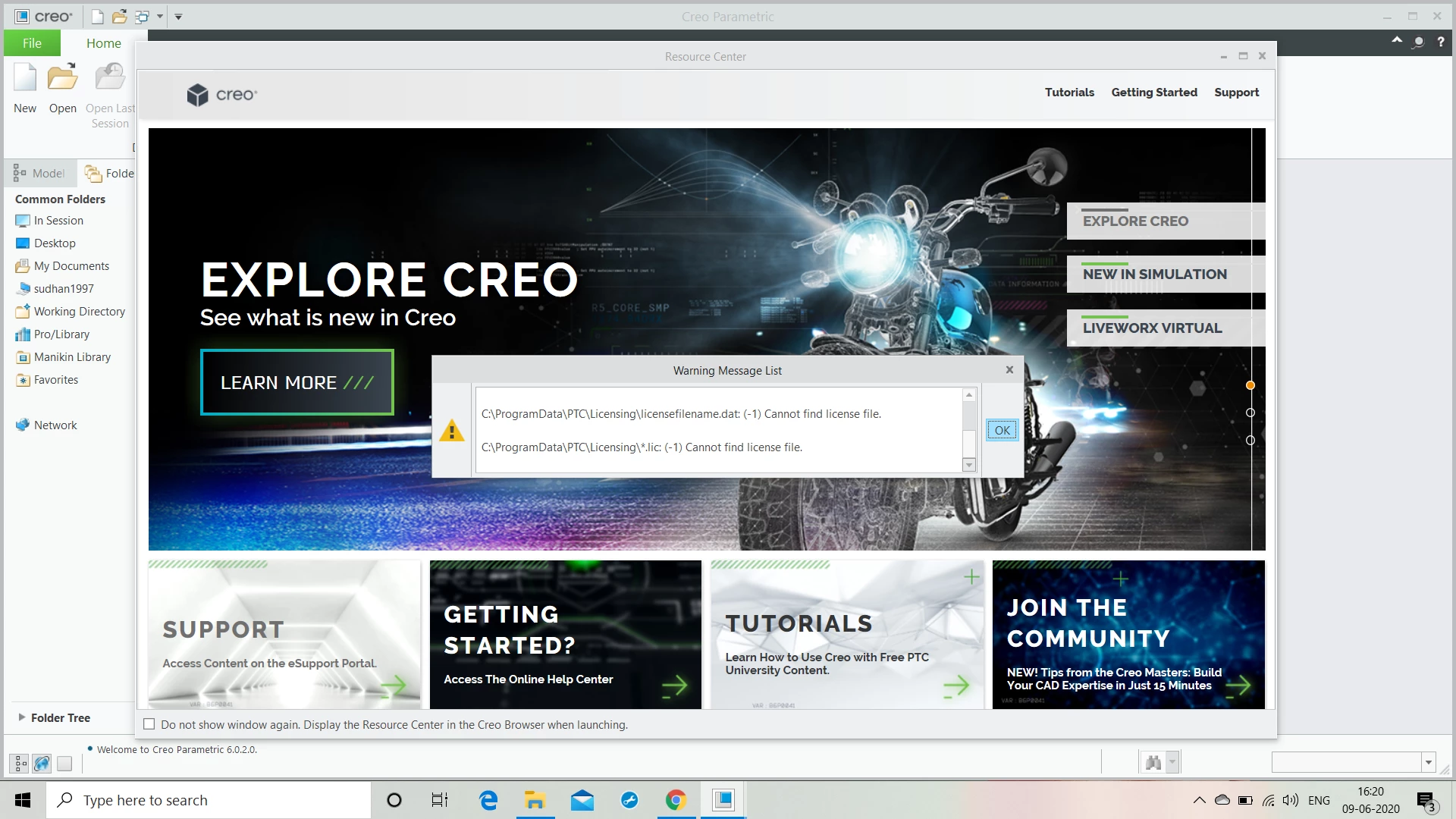

Jun 9, 2020 11:51 AM UTC
I did as you said. but again i get an something error message. and I've attached those doccuments with this
