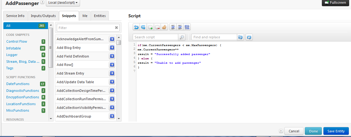

You can find more about ThingWorx Services in the Help Center and also on the plms training
Digital Media Publisher
I am not aware if there is a way to see the code for the getImplementingThingWithData service of a Template..., but you can use the snippets sections when building a script. This will help you get started with the specific syntax used by ThingWorx Entities.
