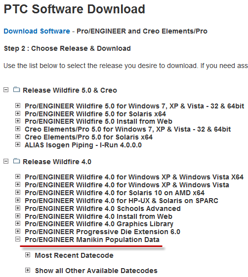

    December 6, 2010
    If you want to use Creo Elements/Pro's manikin module, the full library and population data is located at http://www.ptc.com/appserver/cs/software_update/swupdate.jsp

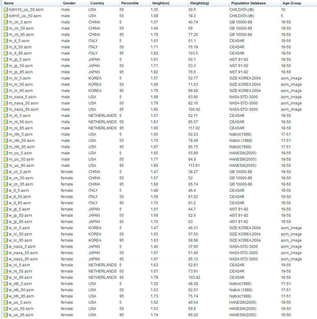

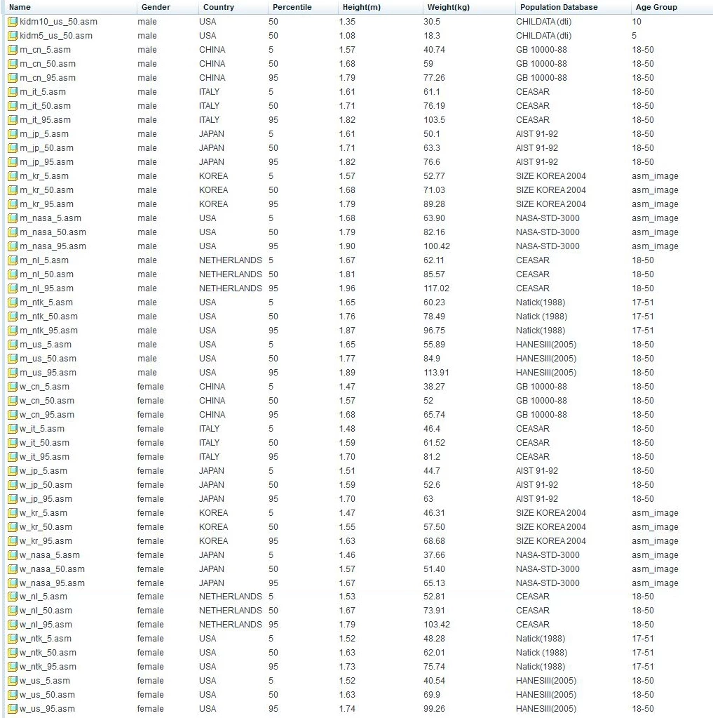

    December 8, 2010
    Index of Pro/ENGINEER Manikin Population Data Version 2.0 (Created by Pro/ENGINEER Wildfire 4.0 M070)
    December 8, 2010
    I was able to download the software update with the manikin library, but where do I find the manikin completely assembled? It seems as though I have all the parts but the assembly of the manikins are not complete.
    December 8, 2010
    Dave, Vlad's message contains am image with the full list of assemblies. Please take a look at the Help Center for Manikin.
