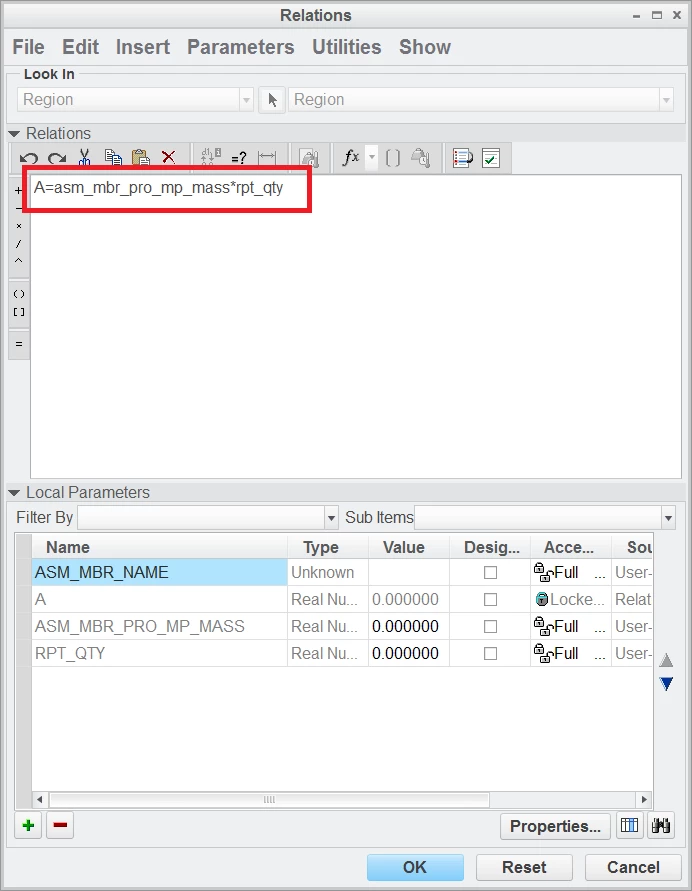

pic1 ... my repeat region containg rpt.rel.A

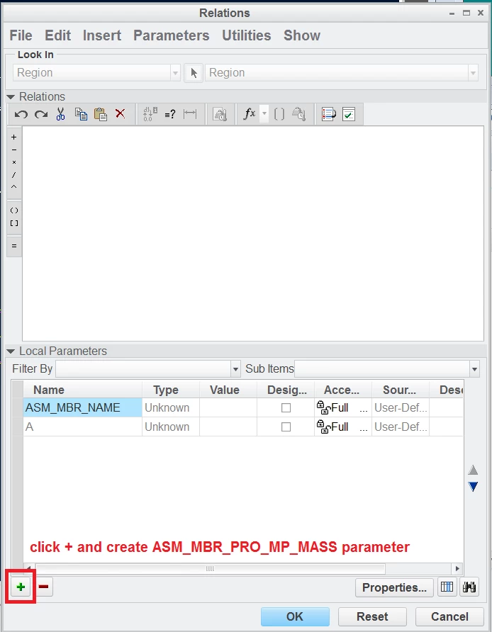

Table > Repeat Region... > Relations > select the repeat region opens following dialog box

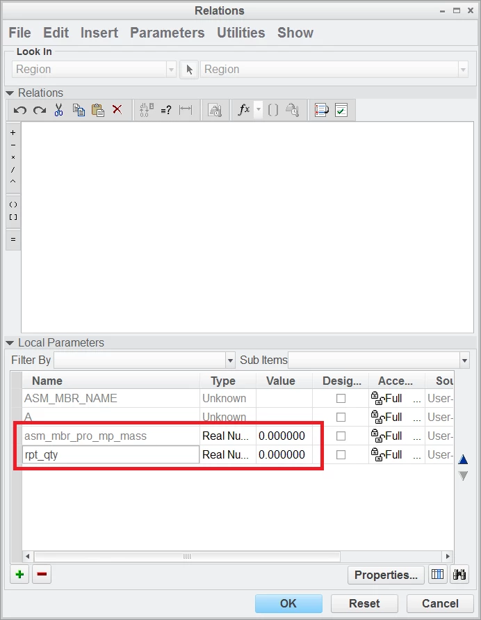

I had to create both parameters
when parameters are available, you can add relation
result is above

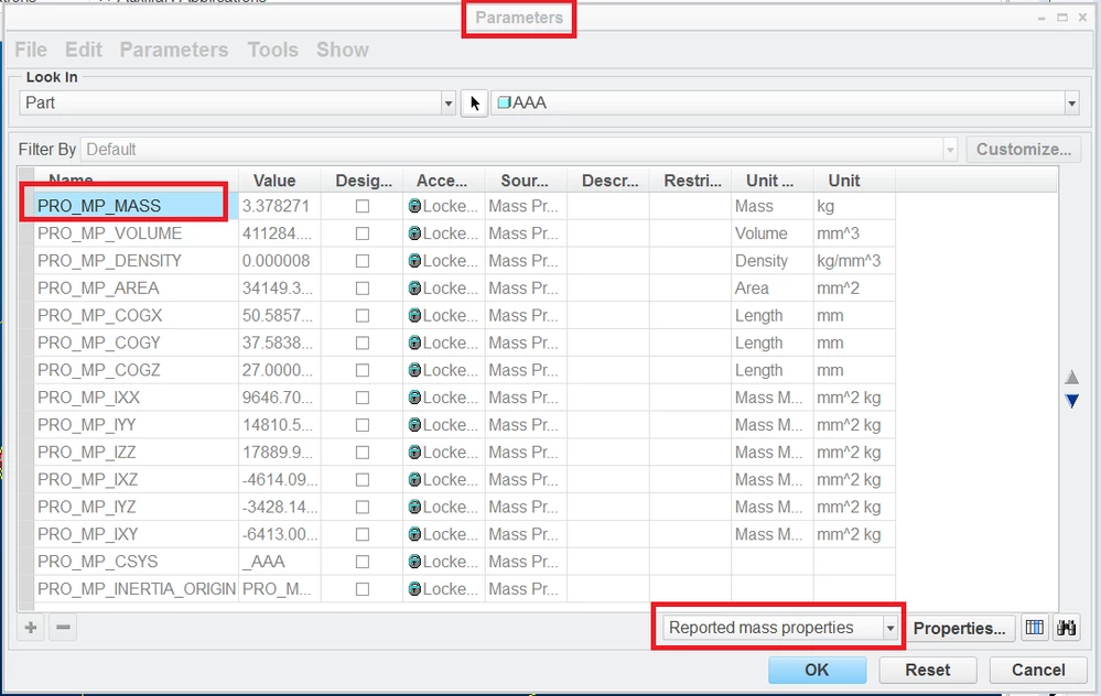

you can see PRO_MP_MASS parameter in Parameters dialog box
I suggest you to use asm.mbr.pro_mp_mass in repeat region.
Ramax1-VisitorAuthor
March 4, 2019
Hello Martin,

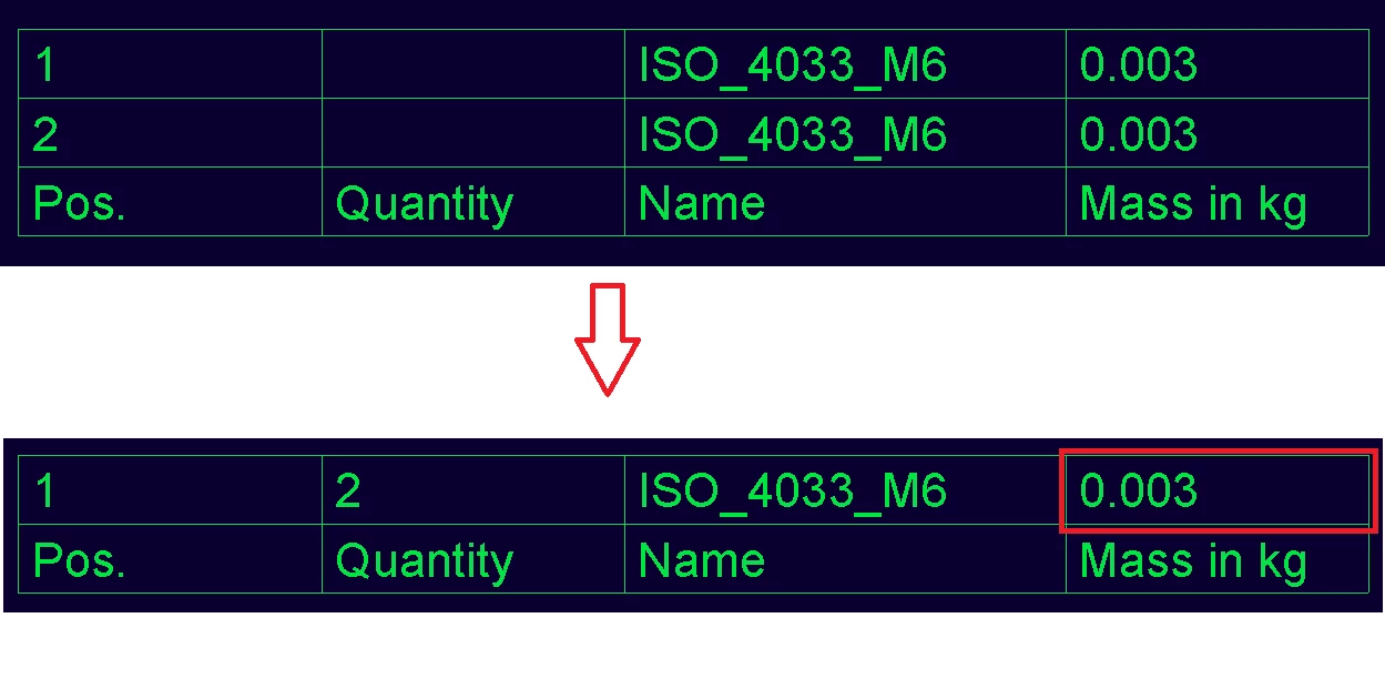

I'm running out of words to thank you :). I hadn't switched to "reported mass properties", that's why I couldn't see pro_mp_mass. Reporting pro_mp_mass in the repeat region works fine, but I have one last problem to overcome: When I set "No duplicates" for the repeat region, the mass displayed for items with quantities higher than one is the mass of one piece, not the mass of all pieces combined (see attached image). Do you (or someone else) know how to change that?
