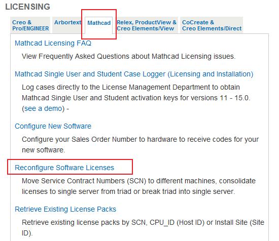

    Provided that you have active maintance, to transfer the license to another computer, you should use the option "Reconfigure Software Licenses", here: http://www.ptc.com/appserver/lm/rsl/reconfig.jsp
