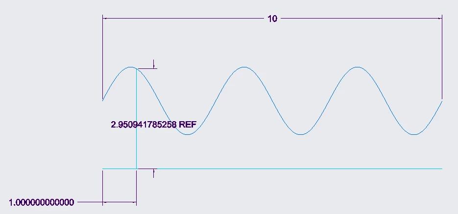

Also you can create Sketch feature and show its annotations.

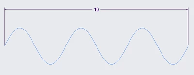

I do not know why Creo does not enable you to measure the distance between curve endpoints.
Suggestion: Activate Annotate tab, click Dimension button and create linear dimension.

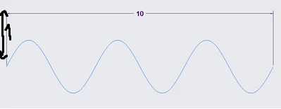

Thank you! It works! How would you create a similar dimension bar for the vertical amplitude? (i.e., a dimension bar showing "1" for the distance between (0,0) and (0,1)? since there is no pre-specified point in (0,1), I guess that using "sketch" is my only option? see attached)
I do not understand your picture. Maybe attached video will help.
Note: I am not sure whether student license enables you to create analysis feature.
