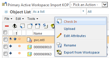

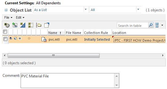

I have a problem and I hope enyone could help me with that.
How can I create a .mtl library at the First Windchill server?
I save the .mtl-file in my workspace but i couldn't check it in. Also the .mtl-file was not shown in my workspace at my browser.
What do I wrong?
    sm_01Answer
    July 28, 2014
    Robert, assuming you are in Creo, the Material file (.MTL) can be checked into your Windchill Project in any folder. Just right click on the file, wait for the menu to appear and then pick Check In. This option is only available while viewing the workspace from within Creo, not the browser.

    sm_011-VisitorAnswer
    July 28, 2014
