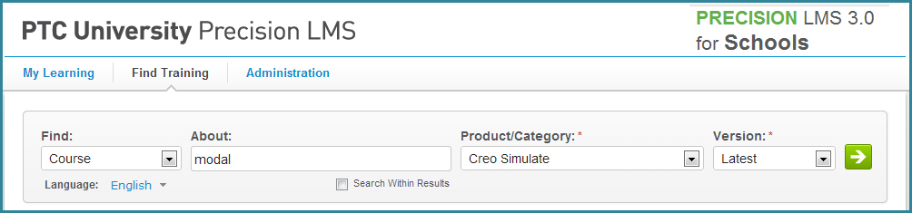

Teachers and students can learn how PTC Creo Simulate works here: Precision LMS for Schools.
