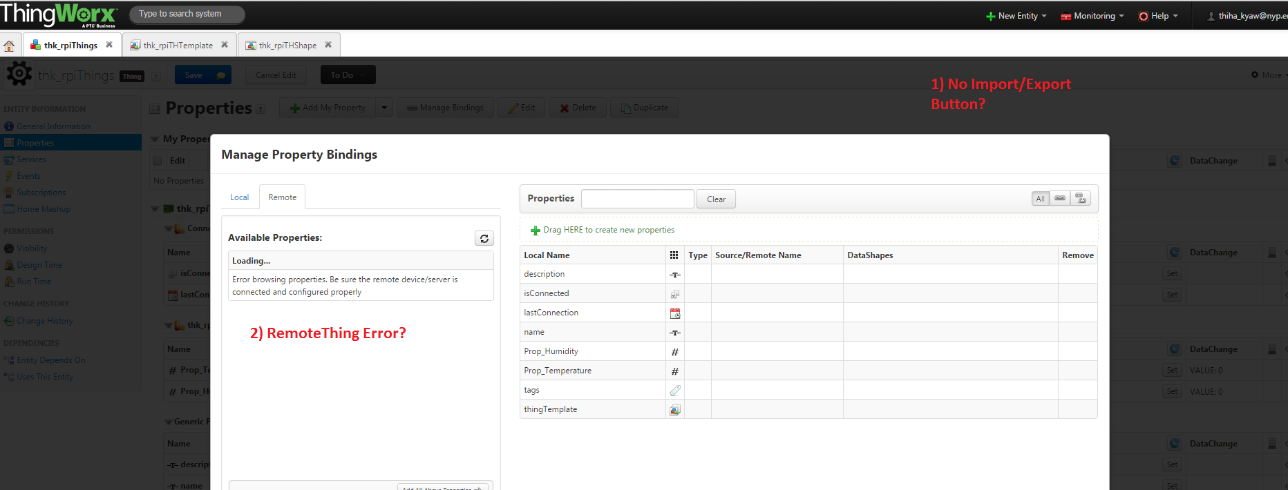

December 30, 2015
Hi Veronica Mihai,
1) I didn't see any import/export button in my thingworx composer. Why?
2) I followed tutorial but I have a problem in RemoteThing. RemoteThing is automatically appeared or how can I create it?
Please advise me how to solve it.
Thanks.
January 4, 2016
Hi Thiha Kyaw,
You need to have administrator rights in order to see the import/export buttons. If you need to import/export something and don't have administrator rights, please contact the professor that gave you access to the instance so that he can import/export it for you or request this from the thingworx-academic support at this email address: iot-academicSupport@ptc.com.
The error you are seeing in the remote thing is due to the fact that the connection of your Raspberry Pi to ThingWorx was not successful. Did you manage to run the jar file on your RPI? What messages are shown in your command line ?
