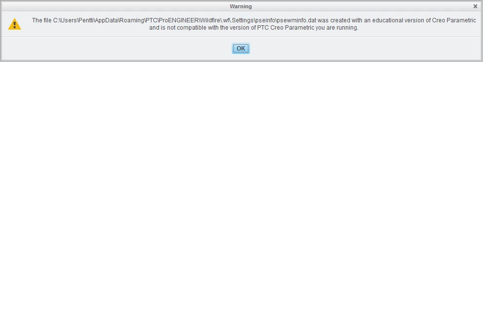

Hi Creo people!
I have downloaded 2015 a 3.0 Creo educational version, and now this year when I start Creo 3.0 Parametric I get an error code which is in an appendix( that's in .png file and is a printscreen take).
Perhaps my Creo licence is no more valid, still when I downloaded that it should last about 2 years.
Thank you for your help,
Pentti
    February 24, 2016
    go to C:\Users\Pentti\AppData\Roaming directory and rename PTC directory to PTC_old.
    MH
    ppeltola1-VisitorAuthor
    February 24, 2016
    Hi MH,
    Thank you for your answer. It may be correct, but I checked Creo error message again and it showed that my license expired in 15.02.2016. So. I uninstalled it and loaded Creo Elements/Direct 6.0 for training Creo.
    Thanks again,
    Pentti
    February 24, 2016
    I hope you know that Creo Parametric 3.0 and Creo Elements/Direct 6.0 are quite different applications.
    You can ask PTC to prolong your license. See:
    https://community.ptc.com/t5/PTC-Academic-Program-Discussions/Creo-3-0-student-edition-license-expired-how-to-re-license/td-p/39530
    ttp://apps.ptc.com/schools/references/relicense_creo3_schools_standard.pdf
    MH
