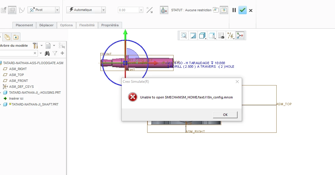

My CREO Parametric 3.0 version crashes when assembling with a pin as a joint
As i said in the subject, my CREO Parametric 3.0 version crashes when assembling with a pin as a joint. Like if i try to transform a link between two assembled parts into a pin, a particular message pops (you can see it on the picture below). As soon as i click on OK or on the cross of this message, my CREO document instantly disappears. I tried to reinstall CREO to see if i deleted an useful document but nothing changed. Coud you help me ? What can i do ?
Hoping someone will be able to save me, have a good day.

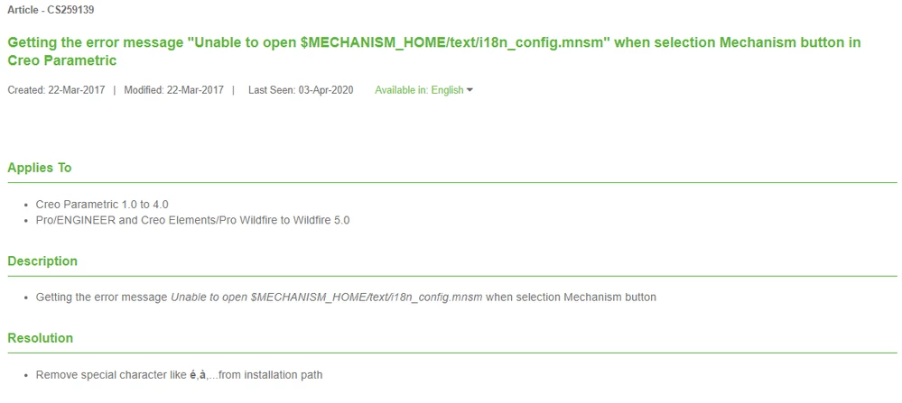

did you look in the knowledge base?
When searching the error message, the following article is available : https://www.ptc.com/en/support/article/CS259139
NathTats1-VisitorAuthor
April 3, 2020
Hello Remy,
I'm sorry but i don't know where to find the knowledge base. Moreover, i couldn't find the solutions to solve my problem on the link you shared.
