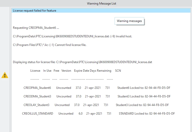

Dear Support Team!
I have a big problem. I downloading and installed your student version of creo6 and at the beginning, as I just opened the window and made a simple model, all worked. I closed creo and then opened it a couple of hours late and here I were. In an attachment I showed the problem.
I hope I help me.
Sincerely yours
Yehis

Creo installer selects the appropriate network card and uses its MAC address to generate the license.
In your case it was 82-94-44-F8-D5-DF.
Error message shown on picture tells you that MAC address 82-94-44-F8-D5-DF is not available anymore.
Question: What did you do with your computer after installation ?
Note: You can open Command prompt window and run ipconfig /all command. Look for MAC address 82-94-44-F8-D5-DF in command output.
