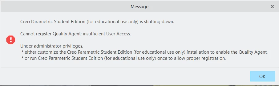

So, I just downloaded the student edition of Creo parametric 6.0 but I can't succesfully enter the program to use it because when I open it, I get this message:
So the problem now is that I have no Idea how to access "administrator privileges," or where to find it.

When searching the knowledge base with the error message you can find this article:
https://www.ptc.com/en/support/article/CS226683
please give it a read
