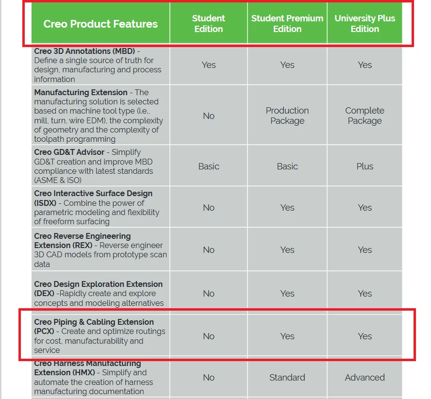

I downloaded the PTC CREO 9 student version and i want to know if is possible to use the pcx extension ?
I want to use the cabling function just so i can learn how to use it to get a job or intership more easily, i've seen a lot of videos about this function, but i have never found out how to install it
Best answer by VladimirN
In accordance with "Creo Education Editions Comparison Chart":
VladimirN24-Ruby IVAnswer
August 7, 2023
