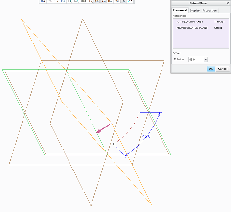

Now I am starting to model, I'd like to make a datum plane with angular offset.
I click the plane in the datum group.
Then I select a plane for which I want the new datum plane go through (I select the through from the drop down menu.).
I try to select one more plane using control button. I can not select more planes or objects as references (The datum plane placement window is open.)
How to proceed forward?

    You will need an axis to act as a pivot and a plane to measure the offset angle from - use the <Ctrl> key to pick the two references

    Seems as if the angular offset needs at least one axis to function.
