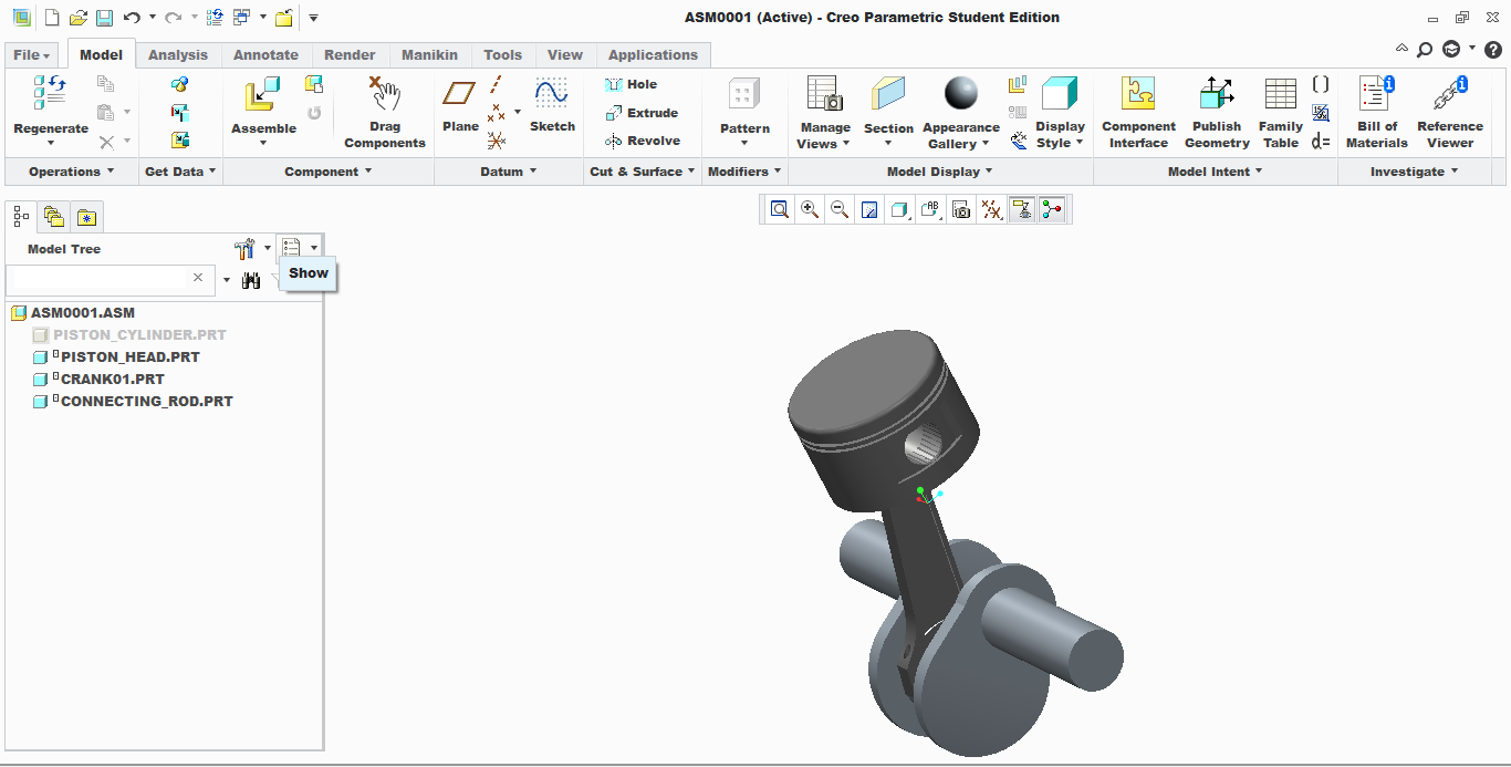

Please Help. I Cant remove Material, "Remove Material" Greyed out!!!

    I can't tell, but is "Revolve 1" a surface? It's not possible to remove material from a surface with solid operations.
    That's the only thing that occurs to me. If that isn't it, use the advanced editor (the nearly invisible text in the upper right corner of the Reply editor window) to add the file.
    I don't have an academic copy, so I can't open it, but other users may want to, if "Revolve 1" is not a surface.

    I am almost sure "Revolve 1" is a surface, because of its color.

    yep, Got it can't remove material from surface.THANKS FOR HELP!!! PCASM.png.
