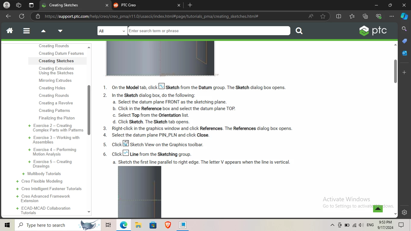

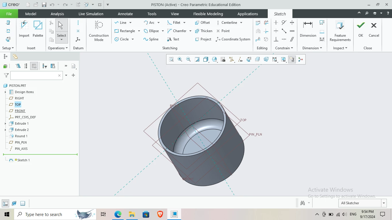

I have just started learning the basics of Creo Parametric (version 11.0.0.0) using PTC tutorials. In one of the exercises, a step instructs: 'Right-click in the graphics window and click References. The References dialog box opens.' However, when I right-clicked in the graphics window, nothing happened. How can I open the References dialog box and complete the steps? Please help. Thank you!

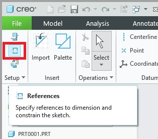

Best answer by MartinHanak
short RMB click is not enough. Please hold RMB little bit longer until dialog box appears.
You can also click button highlighted on following picture
