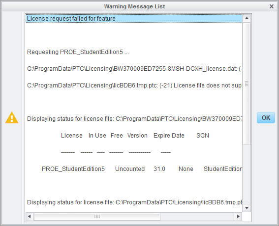

Pro-E/Creo student edition 5 license server reports "license request failed for feature"
  • July 11, 2015
  • 1221 views
I bought this license last week, and have reinstalled several times. Have installed CREO 2 and CREO 3, including trials. Same error. I also cleared all licenses before each install attempt.
What do I need to do to get this software to work?
July 27, 2015
PROE_StudentEdition5 is license for ProE Wildfire 5.0 or lower. You cannot use it to run Creo 2.0 (33.0) or Creo 3.0 (34.0).
Ask PTC to send you current Student license.
Email you request to -
-OR-
enter your request on http://support.ptc.com/appserver/support/academic_case_logger/academic_case_logger.jsp
Martin Hanak
