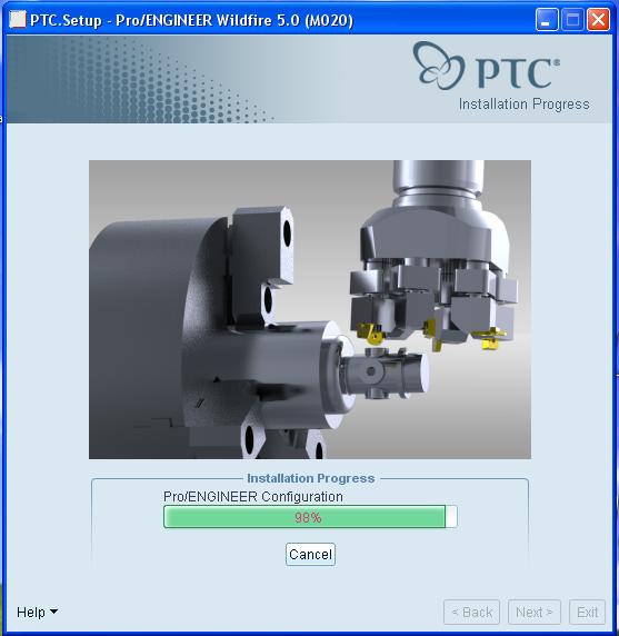

Today I was trying to install my copy of Pro/E on my newly installed copy of Win XP and I've encountered a little problem - the installer got stuck at 98% a point labelled "Pro/Engineer Configuration". Here's a screen shot. It stays at 98% for like 2 hours now. The images are changing tho.

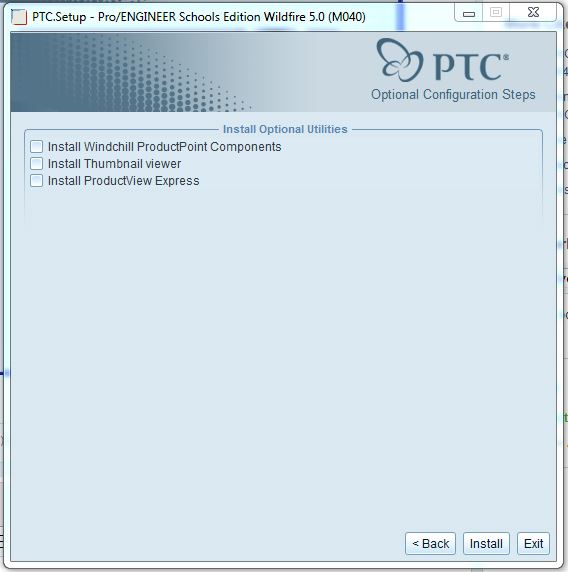

    Can you please attempt to reinstall the edition? However, on the last screen before the install, please uncheck all the boxes. What is happening is the install is trying to run MSI installers to install the various add-on components.

    Well, i've already solved the problem with the installer - just downloaded the setup once more, there was a difference in the MD5 checksum both downloads so it seems that the first one was corrupted in some way.
