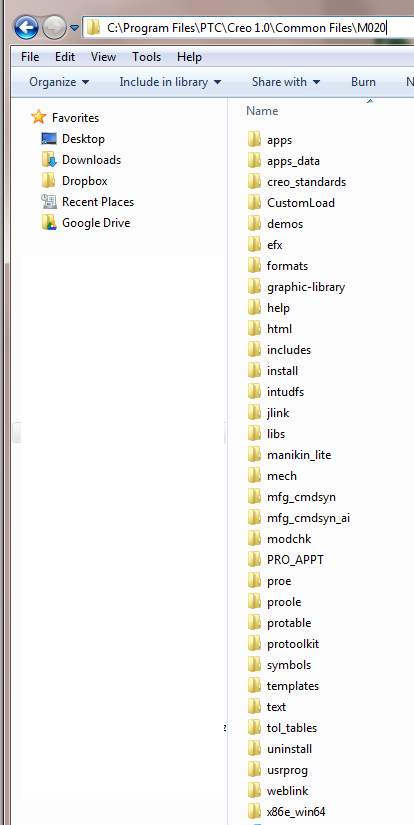

    April 26, 2012
    Im sorry but i cant finf de Folder "Text"
    And i dont think it would be the graphic driver because i just downloaded
    April 26, 2012
    The path will be C:\program files\PTC\Creo 1.0\Common Files\<BUILD NUMBER>\text, where <BUILD NUMBER> is the build number of the Creo version that you installed.
    For example, it may be C:\program files\PTC\Creo 1.0\Common Files\F000\text or if you have installed the latest M020 version it would be C:\program files\PTC\Creo 1.0\Common Files\M020\text.
