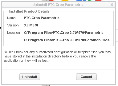

I run Win 7 64-bit and was trying to install the academic version of Creo 3.0 Parametric without success. The problem was with the license and after some googling I came to the conclusion that I should uninstall and remove everything and redo it. Now that I'm trying to uninstall Parametric 3.0 M070 the uninstaller crash.
This is what I get when I select Uninstall in the Programs and Features menu in Windows:

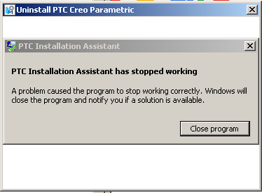

After pressing Uninstall, I get:
And in my process list I now have:

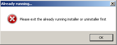

No matter if I keep the process running or end it, when I try to uninstall Creo again I get:

    November 15, 2016
    1.] in Task Manager kill pmuninstall.exe process
    2.] in Windows Explorer go to C:\Program Files directory and simply delete PTC sub-directory
    3.] in Windows Explorer go to %TEMP% directory and simply delete its contents
    4.] in Program list uninstall PTC Creo Parametric and all other PTC items installed on the same date (sort the listing by date)
    MH
