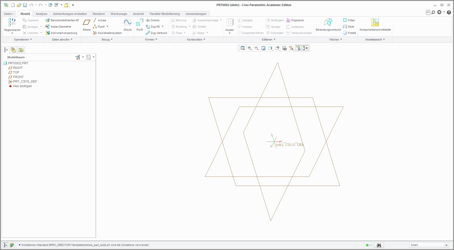

    February 11, 2013
    I have used one of the standard configurations and it´s still the same...
    February 11, 2013

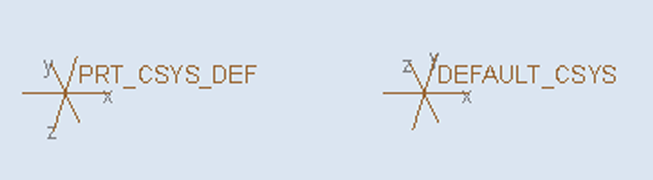

    The coordinate system in your image is that of a commercial template part so you have not configured your installation using one of the Academic Program configuration options.
    In the image below the coordinate system named PRT_CSYS_DEF is that of a commercial template model. You will get this if you do not use one of the Academic Program configurations. The coordinate system named DEFAULT_CSYS is from one of the Academic Program templates.
    It also be noted again that there is no view port orientation concept in Creo. If you want to change the orientation of a coordinate system, you can edit its definition and change it. You could also have multiple coordinate systems in a model, each pointing in a different orientation.

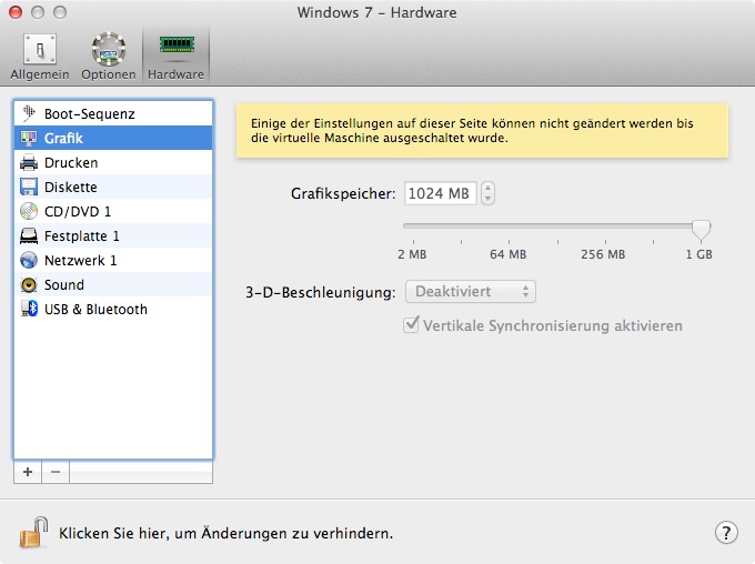

    May 8, 2013
    yes! it worked for me
    May 8, 2013
    Heey thank you so so much, it works !
