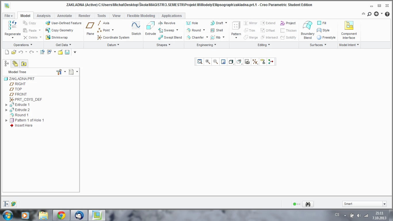

i have a problem with display work area. I have CREO parametric 2.0 students edition.
After starting CREO don´t appear workarea. See attached picture.
Could you give me some help??
Thank you very much.
Michal

    Michal,
    Creo 2.0 is a graphics intensive software and requires your computer to use a supported OpenGL graphics card.
    Often a simple update of your graphics driver will fix the problem. If not, the document link below will provide additional options you can try.
    http://apps.ptc.com/schools/references/support_creo2_graphics.pdf
    Adam

    Adam,
    update of graphics driver was successful.
