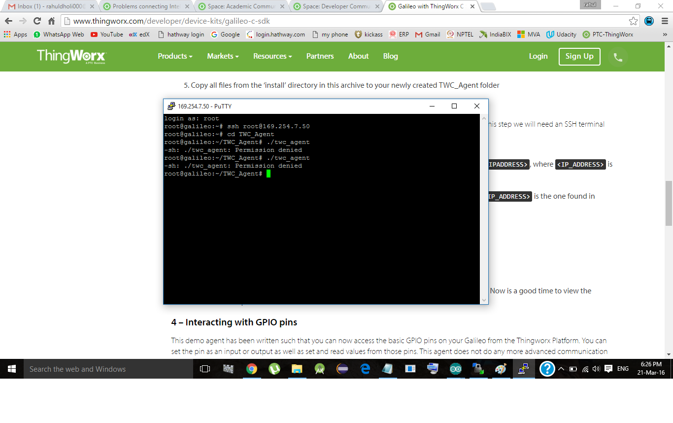

Yes I have connected Intel Galileo Gen 2 to the Internet via ethernet cable.I got IP address using PUTTY(operating in serial mode then "ifconfig" in command window ,I have used baud rate as 115200).I also tried getting IP address via this code:
void setup() {
void loop() {
  system("ifconfig > dev/ttyGS0");
sleep(10);
Both worked and gave same IP address.
(I have followed the steps given on the Thingworx website)
After that for copying files to Galileo I used Winscp l ,I configured following setting -File protocol-SCP ,HOST NAME-<IP address>,Username-root.
Then after logging in ,inside home folder I created  a directory for the app named TWC_Agent.Copied files to to it from Install directory of TWC files(downloaded from thingworx website)
Next step-
In putty I used connection type as SSH,HOST NAME -<IP address>, port -22 and opened the connection
then after logging in as root
then I tried running :-    root@<ip address>
it replied command not found
then I tried ssh root@<ip address>
It came to next line after some processing after this I tried to go into the directory where the files were copied by  "cd TWC_Agent"
The on next line when I gave command to run agent as " ./twc_agent"     to which it replied permission denied.
I have attached the image where i am facing problem.
I don't know where i have gone wrong.

As mentioned and nicely explained in this article (http://stackoverflow.com/questions/18960689/ubuntu-says-bash-program-permission-denied)
you need to use this command chmod u+x program_name. Then execute it.
if you are using Debian then you have to install libmraa too after this to make program work.
