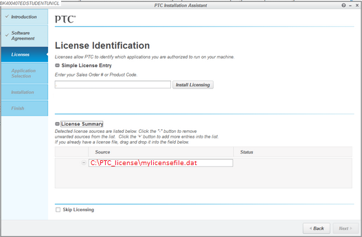

    save license file for example into C:\PTC_license directory.
    Then run installation. Do not enter Product code. Enter path to your license file (for example C:\PTC_license\mylicensefile.dat) into entry field in Source column. Wait for a while - installation will validate your license. Then click ​Next​ and continue with installation.

    Did you really receive such email ? If the answer is YES, then simply save email attachment (this means license file) into a directory of your choice. For example, create C:\PTC_license directory and put license file into it. Again, when you save license file, give it name of your choice, for example mylicensefile.dat.

    Dear Martin Hanak,
    we finally made it!! I did it exactly the way you told me and it worked!
    Thank you a lot!
