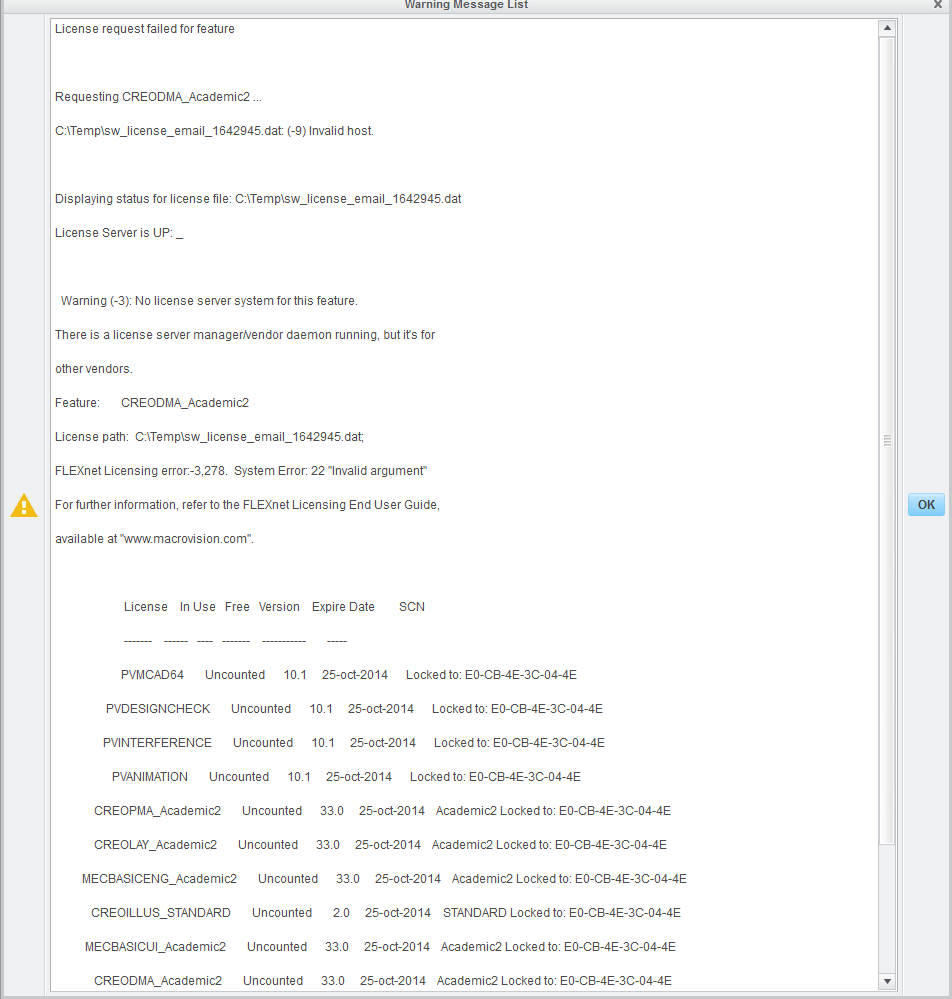

    I too am having issues, initially with the same problem. Attached is an image of the message box that appears when I try to open up Creo:
    I lack any prior knowledge to parse this, aside from that the source of the file in my computer may be off?
    Thank you in advance; my team (2220) is trying to make the switch to Creo 2 before the season begins.
    If I've somehow misspoken, please forgive me, as I'm not entirely sure what the correct etiquette is in this forum.
    I should probably also mention that the fix we attempted to fix installation problems with was a license emailed to me by my one of my team's mentors.

    Hi Nicholas,
    it looks to me like you may have the wrong MAC address. I can see in your license file that it is set up for E0-CB-4E-3C-04-4E. That is probably your mentor's MAC address.
    You should probably run through setup again and select the option to request a license.
