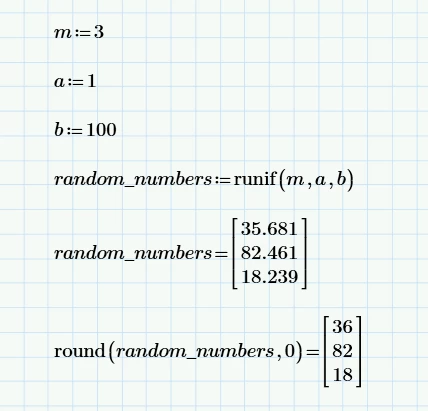

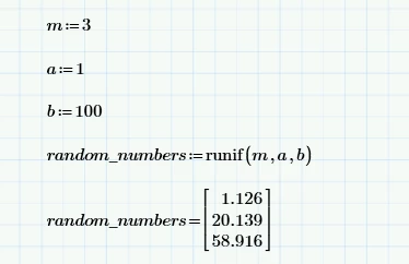

Hi. Im kinda new here at mathcad and I am bad at programming, I am still trying to use the program part of mathcad, how can i program mathcad to generate 3 random numbers from 1-100?
I just want to start with something simple at first.
Thank you.

In such a case, you can use the round function:
"Example: Truncation and Roundoff Functions": https://support.ptc.com/help/mathcad/r9.0/en/PTC_Mathcad_Help/example_truncation_and_roundoff_functions.html

how do i make it an whole integer?
VladimirN24-Ruby IVAnswer
May 14, 2023 1:03 PM UTC
