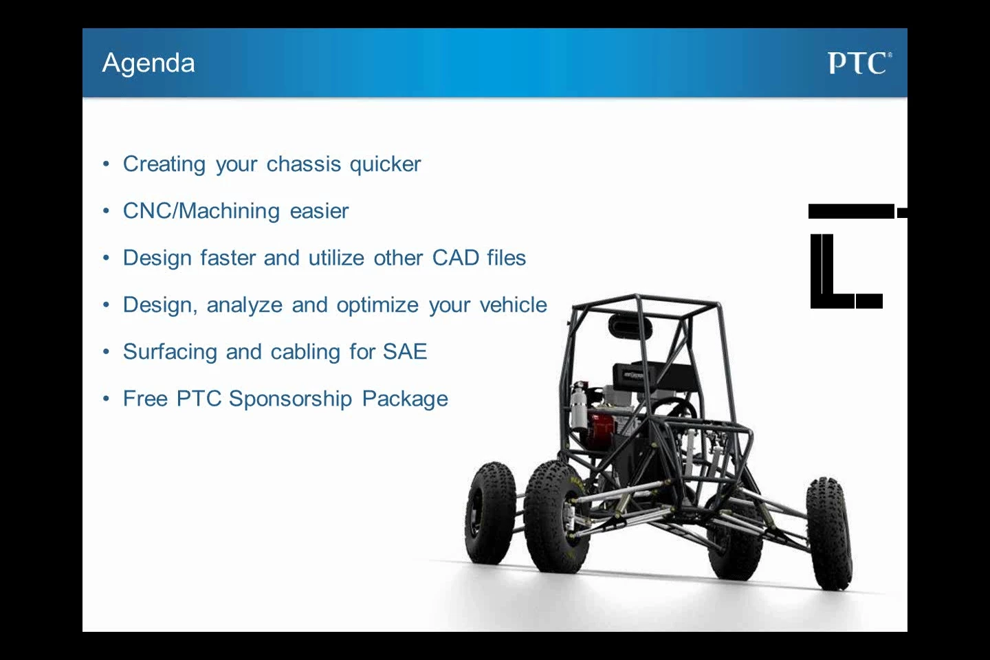

PTC Academic Program: Session Two, SAE Team Webinar
In this session, PTC's Lee Goodwin will take you and your team through some tips and tricks specifically for SAE teams. You'll see examples on creating your chassis quicker and easier, how to CNC manufacture your parts, getting the most out of your analysis, editing models from other CAD tools and more! For free sponsorship and software, visit www.ptc.com/go/sae and for questions, contact www.ptc.com/go/academic-support.
