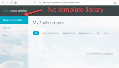

I'm starting the Windchill Technical Essentials course. One of its instructions is to "Create a Windchillvirtual environment from a template".
When I sign into PTC Cloud Portal, there is no Template Library in the sidebar menu, so I'm unable to create an environment:
The browser console has errors:
Any suggestions?
Best answer by MichaelFaux
I raised a support issue and got this response (my emphasis in bold):
> when the partner account has no Cloud Portal credits nothing will show up in the template library for the user. The partner’s admin can purchase credits through the Partner Portal.

Try to report an issue here: https://ptc.service-now.com/sp/
MichaelFaux7-BedrockAuthorAnswer
7-Bedrock
October 21, 2024
