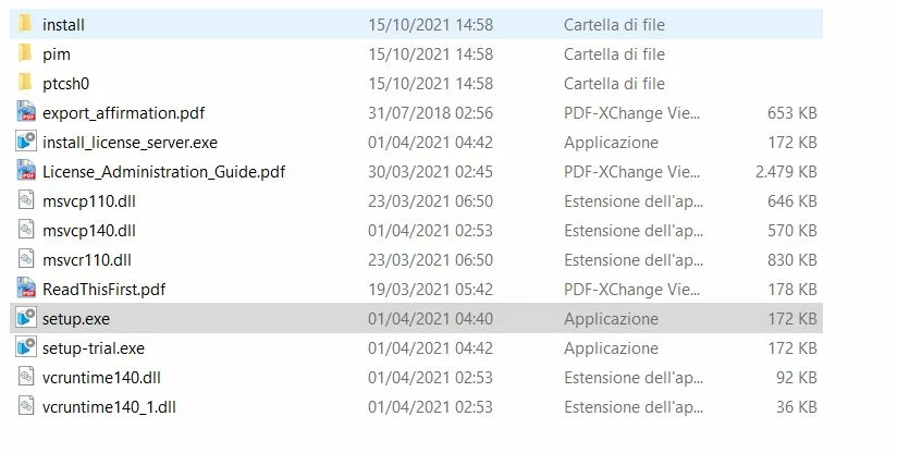

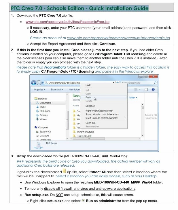

I have downloaded Creo 7 from school PTC program and I unzipped "MED-100WIN-CD-450_8-0-0-0_Win64.zip" archive. Then, following "PTC Creo 7.0 - Schools Edition - Quick Installation Guide", I disabled antivirus and firewall. Then right click on setup.exe --> run as administrator.
Nothing happens.
Suggestions?

1.] MED-100WIN-CD-450_8-0-0-0_Win64.zip contains Creo 8.0.0.0
2.] Path to setup.exe must not contain "special" characters. Place unzipped installation package into C:\PTC_install directory and launch C:\PTC_install\setup.exe

on windows 10 now it works
