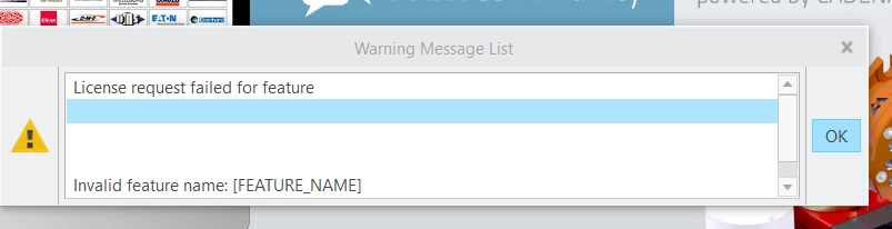

Installing the academic license has shown success. However, trying to run the software provides an error message as shown for a "License requested failed for feature. Invalid feature name: [FEATURE_NAME]"
Images attached.

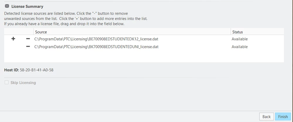

Resolved issue by adding my license (the one emailed to me) to the license file location and running reconfiguration through setup.exe.
