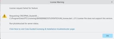

Related to the Licence issue
I am getting this  error while installing this software
Apr 21, 2024 5:43 PM UTC
BK900908EDSTUDENTEDUNI code enables you to install  Creo 9.0, only.
To install Creo 10.0, use BK100908EDSTUDENTEDUNI code.
Before you start installation, remove all files from C:\ProgramData\PTC\Licensing directory.
