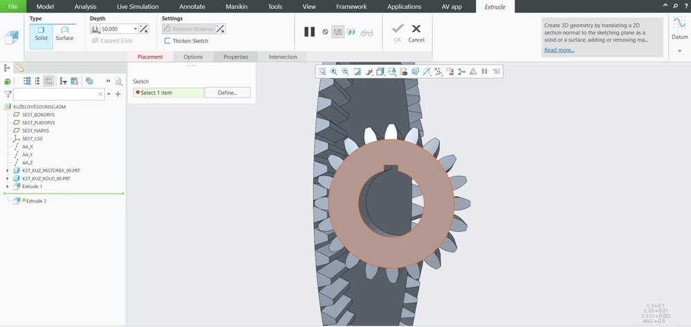

remove material is greyed out

I want to add marerial but it is automatically checked as remove material and i dont know why i can change it to normallCREO 2024-05-31 134817.png

in Assembly mode adding material is not allowed. You have to activate specific part and add material into it.
