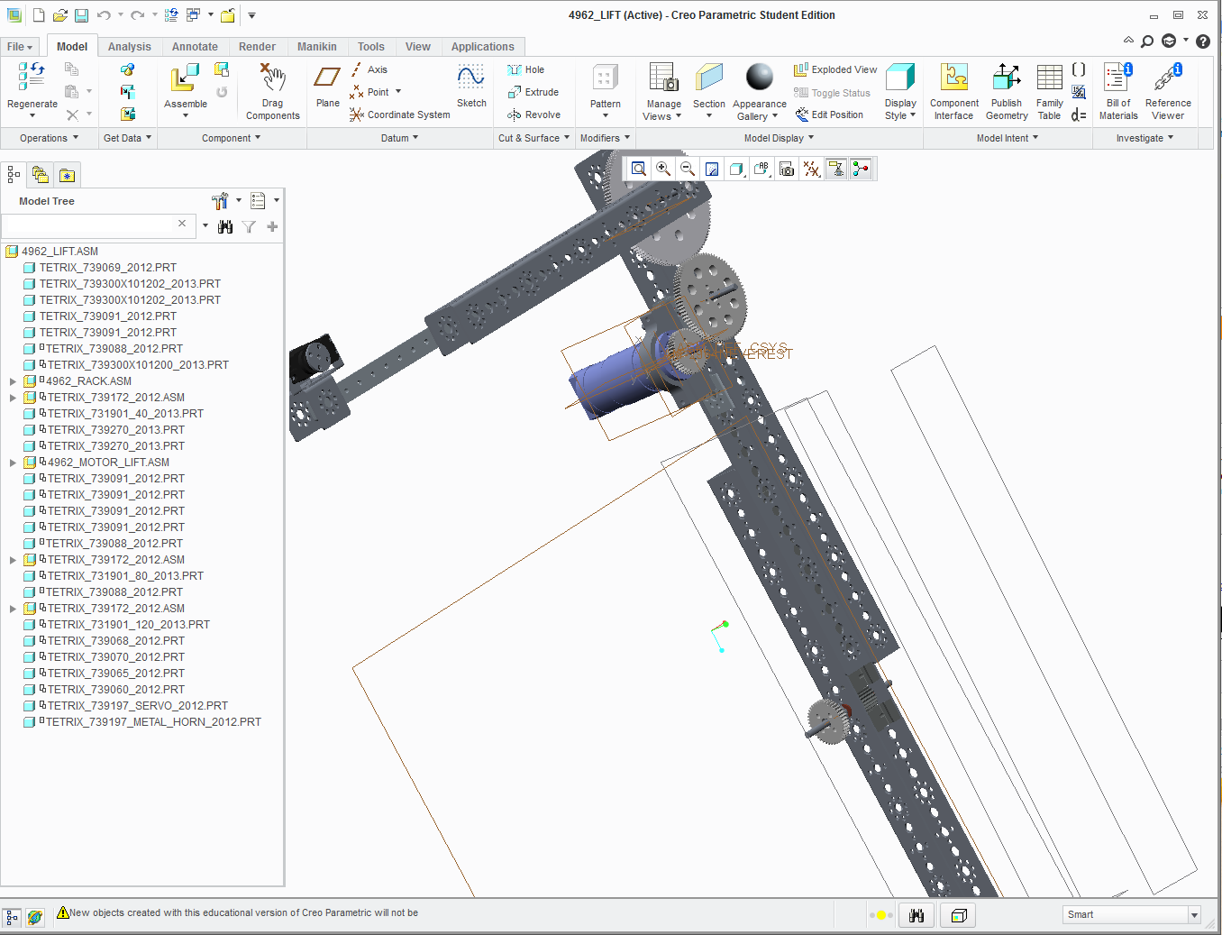

    We tried it again to make a picture for you and it worked correctly this time, so I'm not sure what was happening. It didn't work many times before that! We have the two gears and a rack-and-pinion that are set up as mechanisms. They did not carry over to the mirror, though, and it didn't like the servo horn so we told it to omit it.

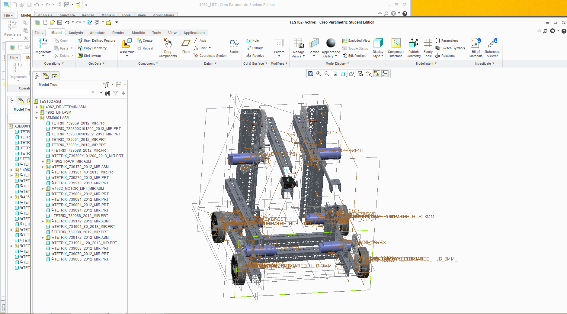

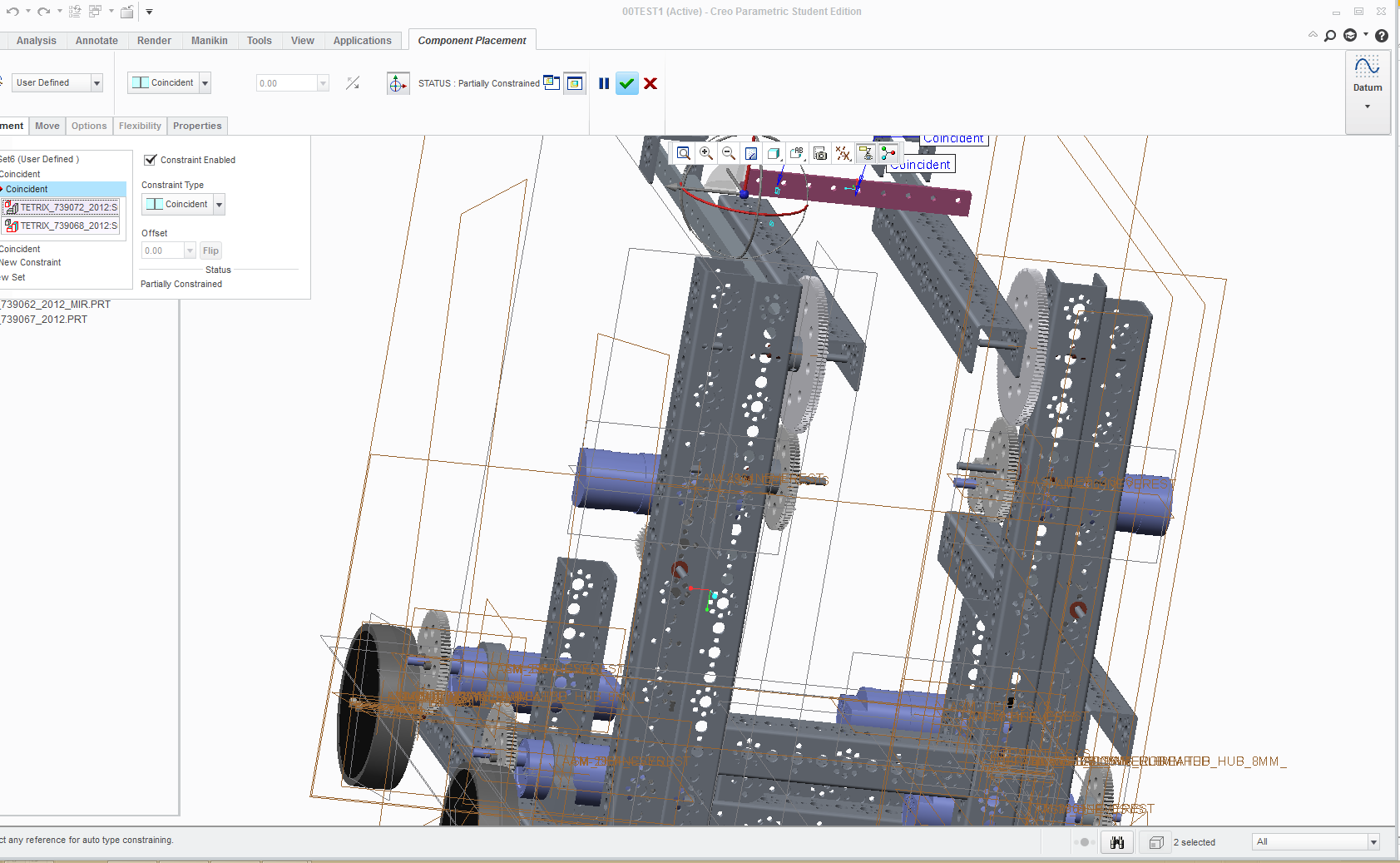

    When we add these to the drive train, we are not how sure to connect them into one larger connected lift (see second picture). When we connect them by a Tetrix piece between the two arms that rotate up and down using a coincident constraint on a couple of the holes, then they either work for a little while and then one of them slips apart or the entire arm becomes stuck and won't rotate.

    When it slips off, the structure sometimes breaks ever so slightly. This used two holes (one on each arm) as constraints and the face of the crossbar.
