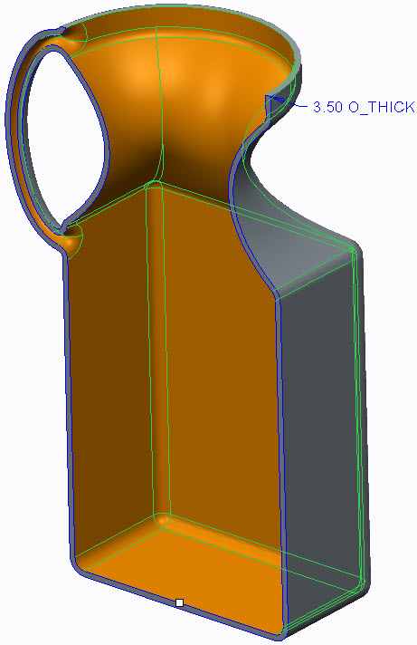

Valid values for the shell thickness are 1.5-3.75 based on the geometry you have. The handle is very small compared to the rest of the bottle and is the limiting factor in the shell thickness. Overall, your geometry is clean, has no error and should shell quite easily. Try suppressing the handle and its rounds and you’ll see the difference.
If you need the wall thickness larger than 3.75, just increase the size of your sketch for the handle sweep.
