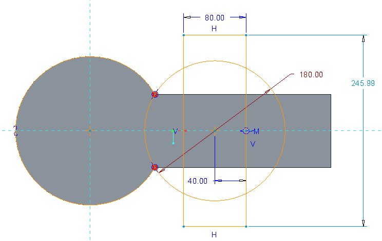

    If I read you correctly I think you like to use features in the model to help create sketches. The CREO version of 'use edge' is Offset. You can create a line from an edge or , by adding an offset value a line parallel to the selected edge or curve.
    December 2, 2014
    Project.PNG Project creates new referenced geometry coincident with the underlying geometry.
    Offset.PNG Creates new referenced geometry at a distance you specify.
