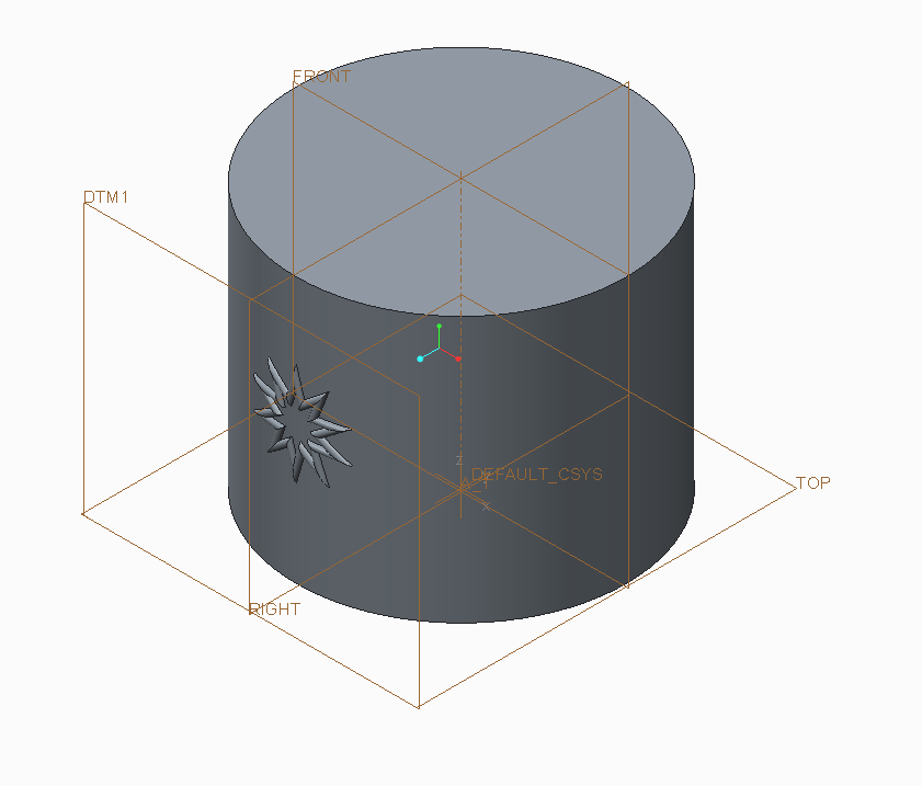

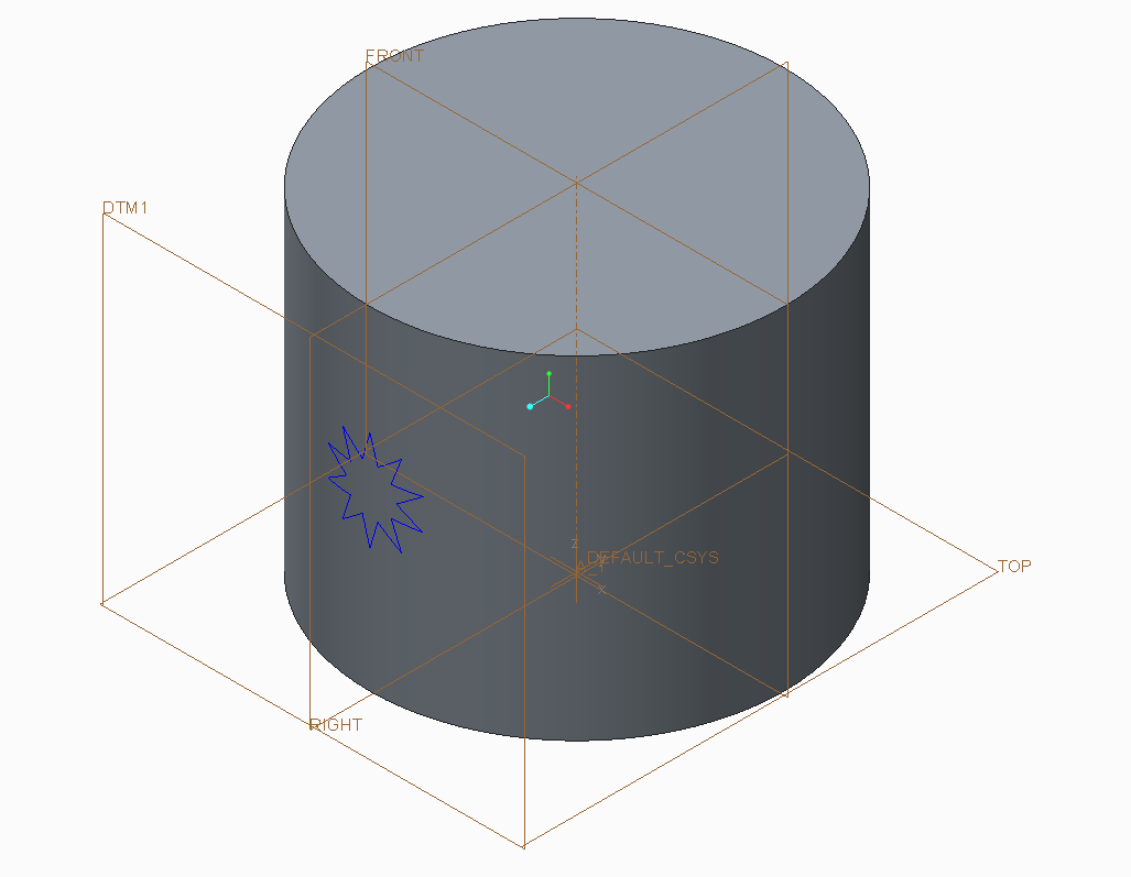

Just playing around with features of Creo that I haven't used before - I have created a sketch on a Datum surface and then projected it onto the surface of a cylinder
as shown:cylinder.png
So the question now is what can I do with it? It no longer behaves as a sketch and won't extrude so if anyone could enlighten me as to the possibilities I would be most grateful.

    ‌if it's a single spline try sweeping a shape along it.  I use this technique to remove material to create door and headlight outlines on car bodies.

    Hi Tim
    Nice one! That's got me going - any more suggestions welcome!

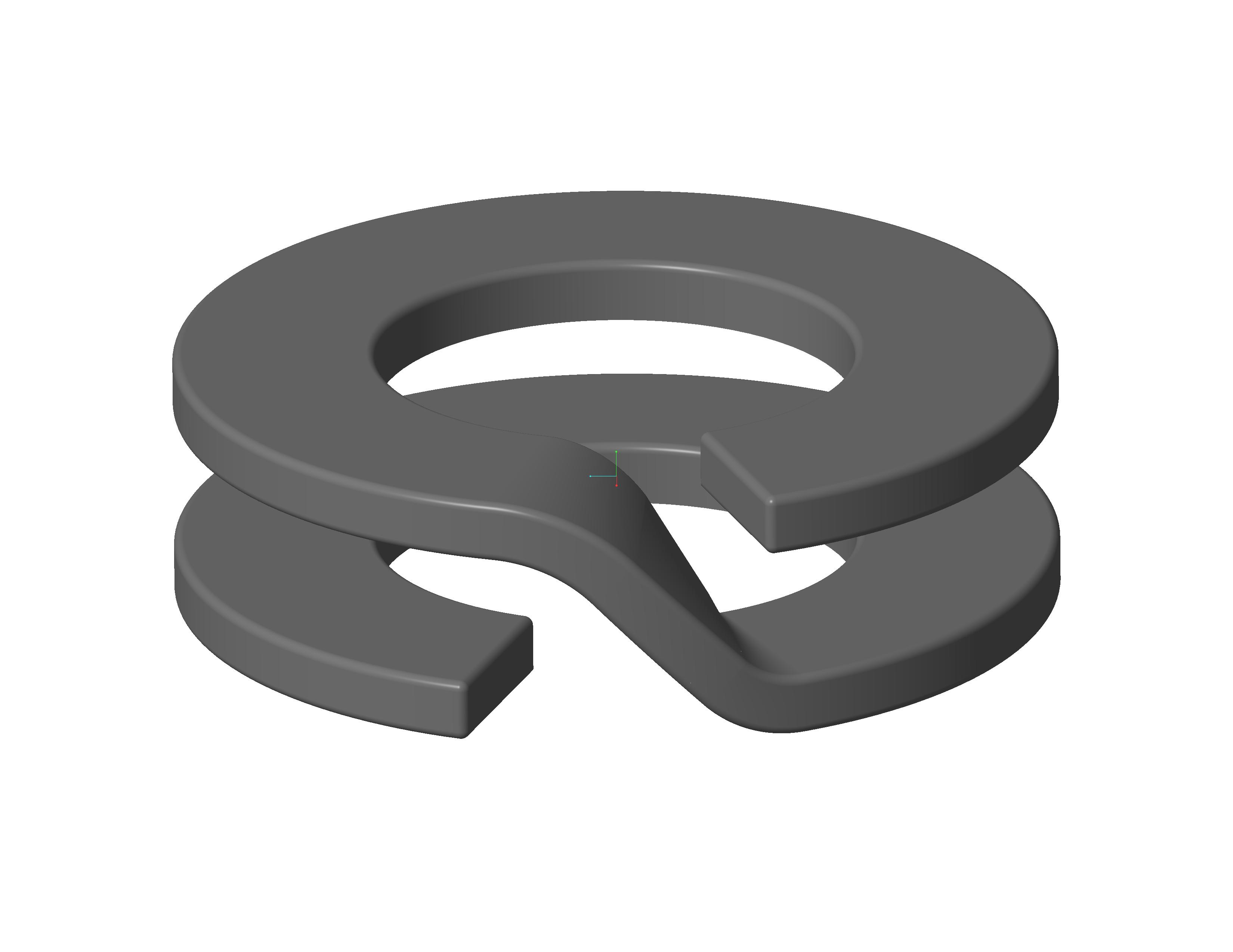

    spring_washer.jpgHi Roy
    I used it to sweep a shape to create a spring washer  I will post the part so you can play with it.  I projected the sketch onto a surface; used the projection as a trajectory and hid the surface.  Parts of the sketch referenced the other features in the model. Have fun.

    Hi John
    A nice idea. Look forward to the posting.
