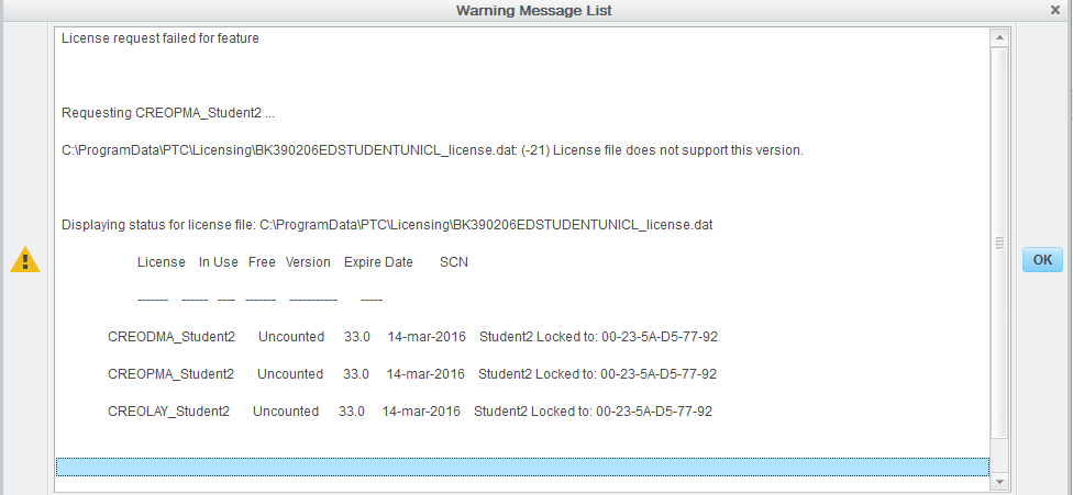

Hi, I have successfully installed the student version of Creo and tried to open Creo Parametric, but the following warning jumped out and stopped me from using the software, what should i do, plz help.

As your license file is locked to the network card used during install, this problem may be solved by changing the state of your Wireless and restart the program.
If you licensed your Creo 2.0 with WiFi on/off you will need to use it with the same setting.
If changing the state of your wireless network card won’t help, let me know.
