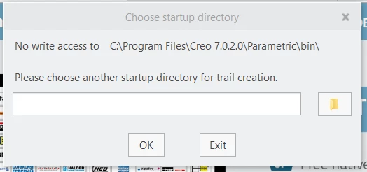

creo 8.0.4.0creo 8.0.4.0
its CREO 8.0.4.0
i have the student licence. it's showing AFX failed and licence request failed
can u will please help to what should i write there.
April 26, 2024
to resolve "No write access" problem, please do following steps:
  • on your Desktop - create shortcut of C:\Program Files\Creo 8.0.4.0\Parametric\bin\parametric.exe file
  • open Properties window of this shortcut and in Start in field enter path to your Documents directory,
    C:\Users\YourUserName\Documents
  • double-click shortcut to start Creo
