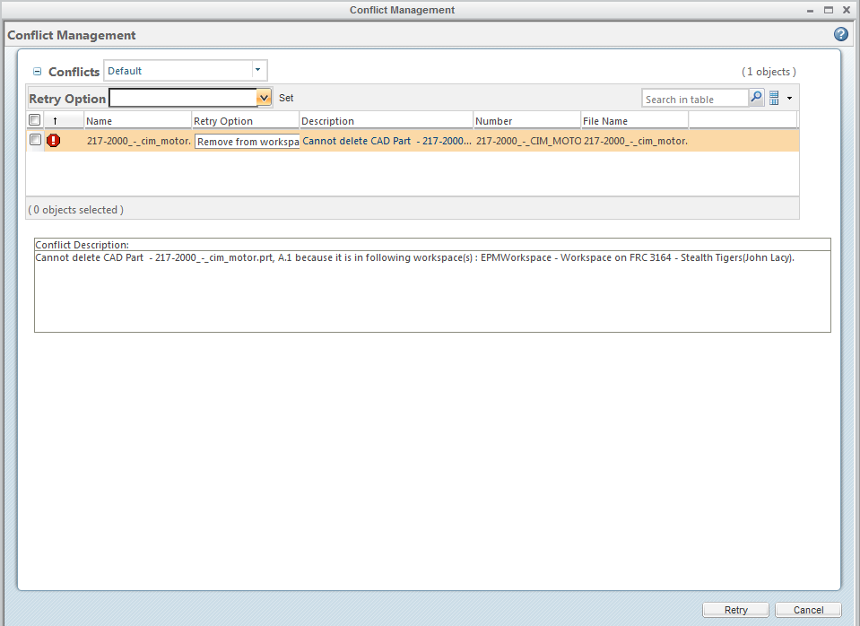

Is there a way to delete and/or clear Windchill Commonspace objects in Winchill's version for FRC? The idea is be able reload the assemblies and parts that seem have become disjointed from being able to be checked in or checked out? While trying to re-engage in the use Windchill with Creo 2.0, we ran into issues with objects being "orphaned". This is where objects appeared to be checked out by a person, yet when this person tried to checkin the object Windchill would respond by stating there is nothing to checkin. After this, we deleted all the objects in the workspace and when trying to resynch "anew" it states that the object already exists and it fails the upload. When I try to delete objects as a project manager that I want to re-upload it tells me I cannot because it is part of EPMWorkspace.

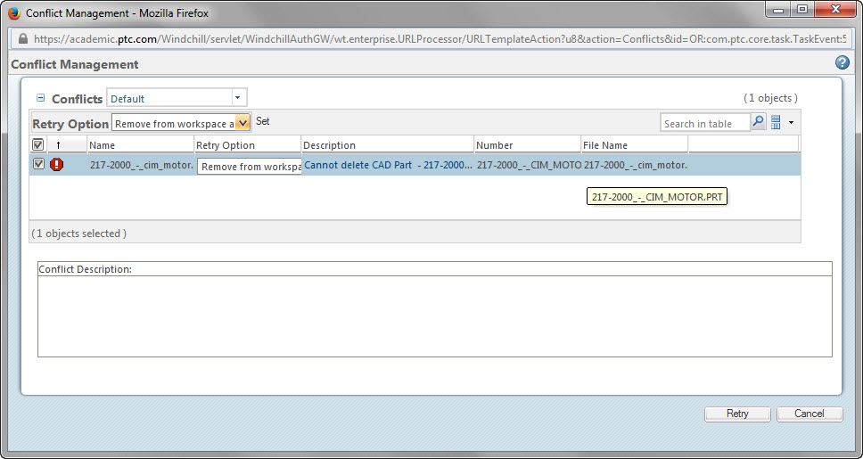

    You are there. You just need to set the Retry option to "Remove from Workspace" for all the items and force removal from other user's workspaces. The file is not in your workspace, it is located in John Lacy's workspace.
    If you are going for a wholesale cleanout, you might want to ask team members to empty and/or remove their workspaces to avoid these conflicts.

    Sounds like you are removing commonspace objects that are also located in a workspace. As the Project Manager, you should have the ability to over-ride this setting and chose to remove the workspace objeects at the same time.
    Send me a PM with all the details and I'll take a peek at your project.

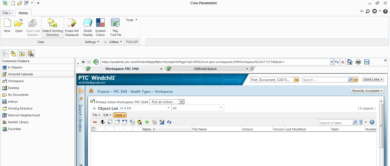

    No workspace is shown as I was able to successfully delete as seen below...

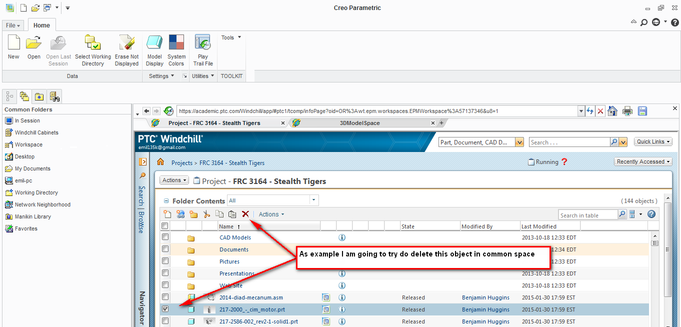

    Will try to delete a single object from common space ....
    Unsuccessful as seen below due to EPMWorkspace conflict...
