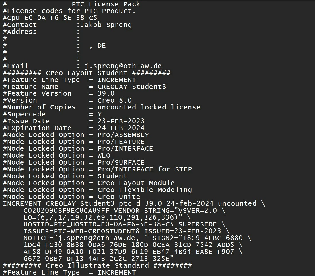

Hey, I've got the same problem, but could not fix it with the instructions above. Could someone please help me out? I've already tried changing my password and followed the relicense guide.  I recieved a document saying that my license is renewed (see attachments), but creo still says that my license expires in 14 days.
My Host-ID is E0-0A-F6-5E-38-C5.
Thank you very much.

1.]
New license file you received via email contains license valid up to 24-Feb-2024. Inside the file there is license code which enables you to run Creo up to version 8.0. You can run 6.0, too!
2.]
To "connect" new license file to existing Creo 6.0 installation, please follow this procedure:
  • save file to disc drive
    • currently used license file is saved in C:\ProgramData\PTC\Licensing directory
  • go to Parametric\bin sub-directory in Creo installation
  • open parametric.psf file in Notepad
  • find line starting with ENV=PTC_D_LICENSE_FILE-=
  • after equal sign there is the path to currently used license file ... replace it with the path to new license file
  • save parametric.psf file
  • find line starting with ENV=CREOPMA_FEATURE_NAME=
  • the name following equal sign must be included in new license file ... check it
  • start Creo
